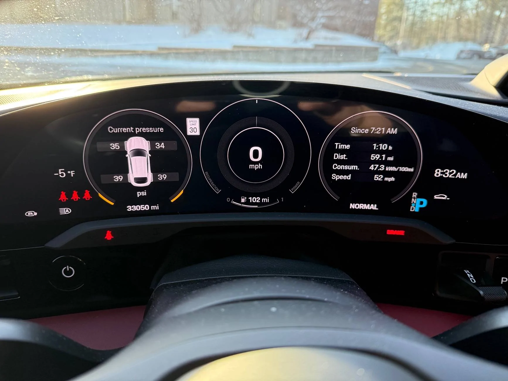

The scenario that many people don’t take into account is that the projected range is based on the temp the vehicle is reading at start up. Often times, your garage is much warmer than the actual outside temp. Therefore the true expected range is only known when you start driving.
As an example, it was 45 degrees in my garage at startup. This was today’s temp in the parking lot at work. Needless to say, my range was recalibrating during my commute.
Porsche Taycan Poor range 2021 Model 4S IMG_3801

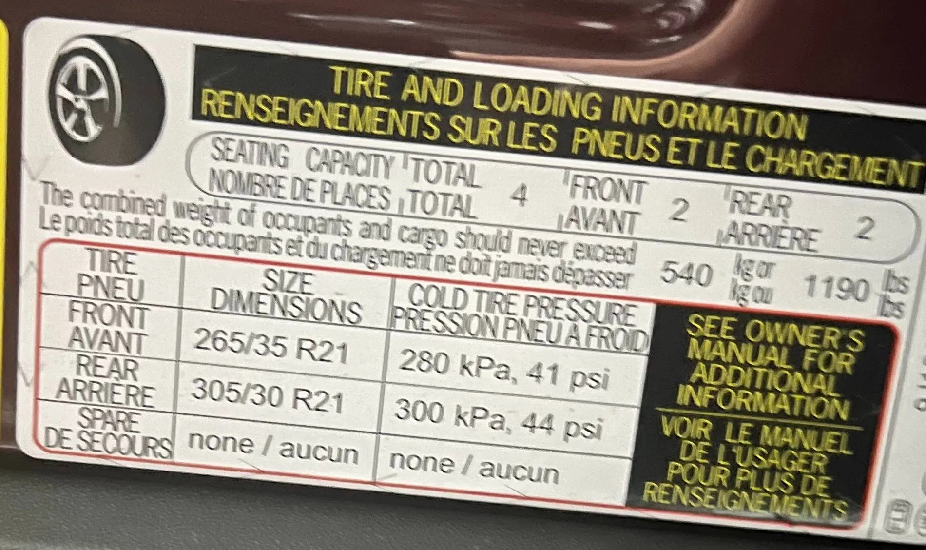

M3Taycan
Mar 3, 2024
103
105
Virgina
X2, Taycan 4S
@Albeeww @RAHRCR Please check your tire pressure when it’s cold. Here’s the recommended cold tire pressure for my Taycan 4S. Keep in mind that each car comes with different options and tires, so the recommended cold tire pressure will vary based on the Taycan. This picture was taken from the driver's side door.
You are offering great advice, when temps drop your TP will be greatly reduced. when temps got cooler here in FL my TP dropped 8lbs.
