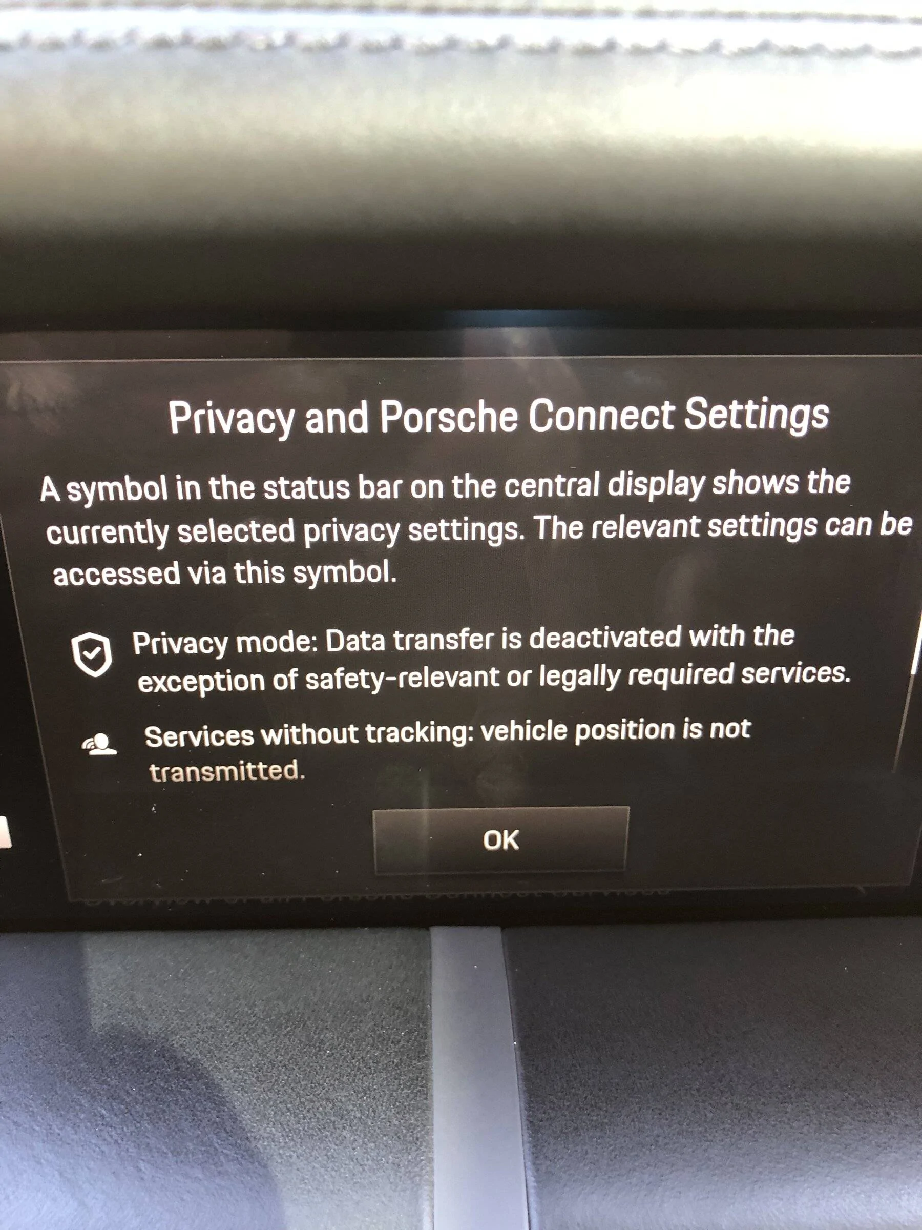

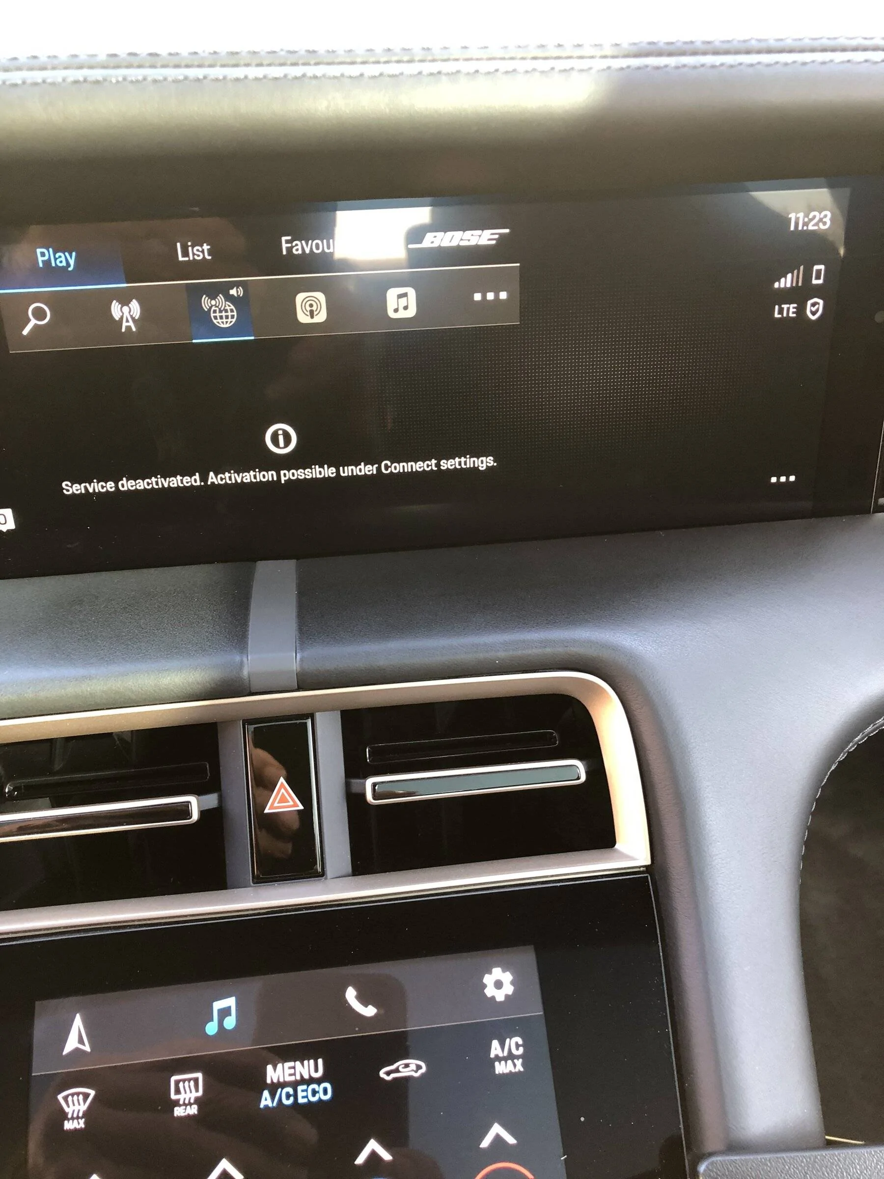

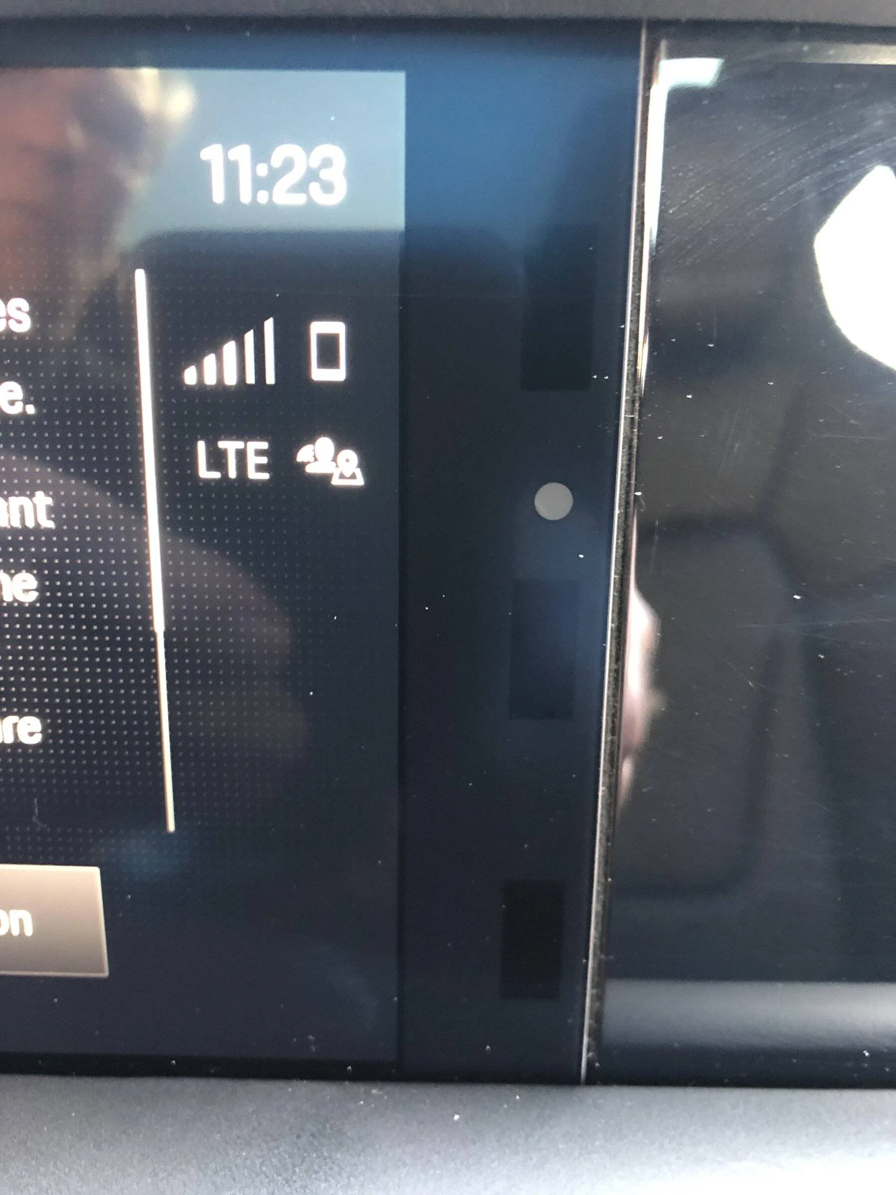

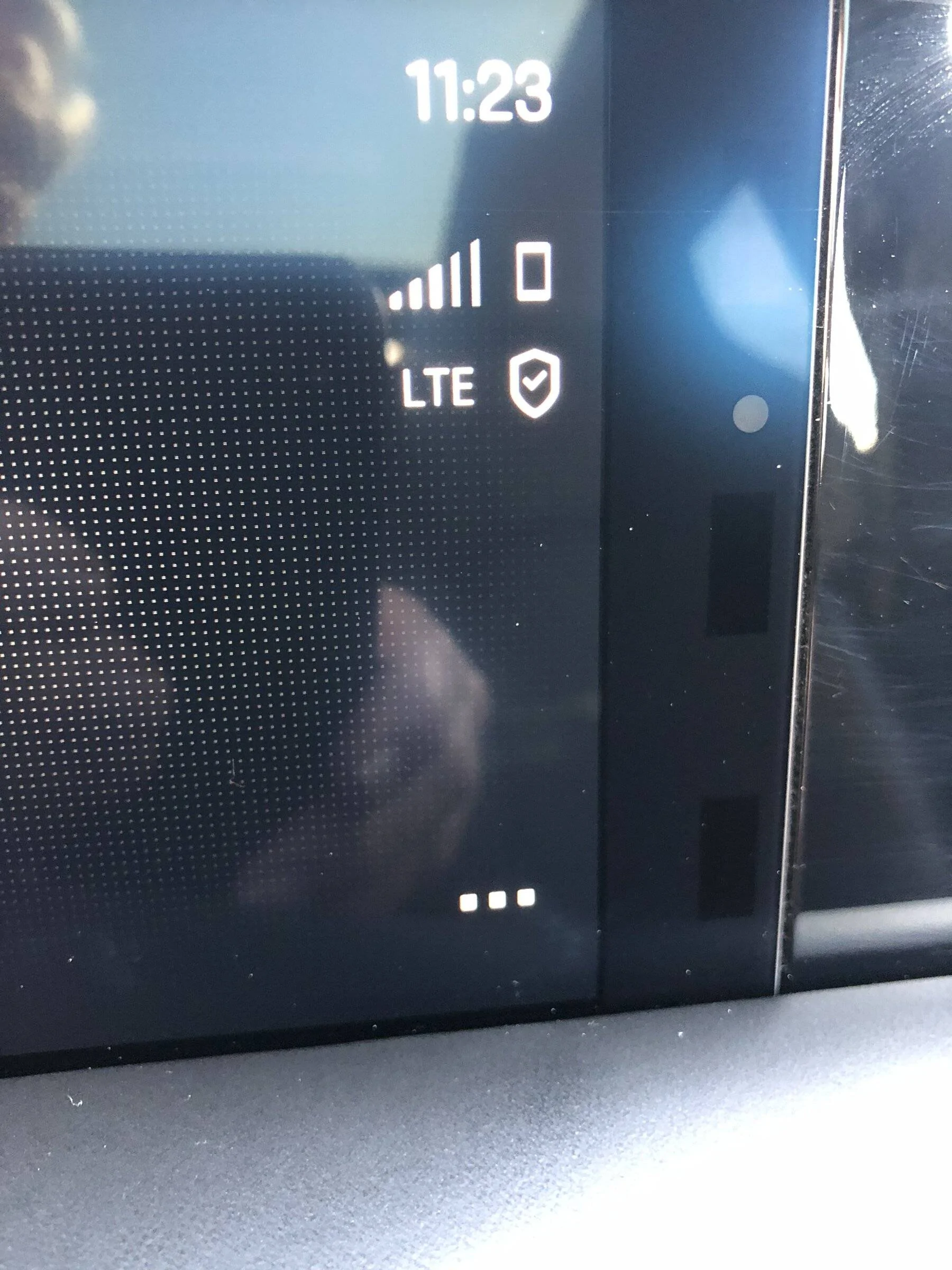

I just checked on my car and will include some photos below. If the functions are the same in US as here it may help you.
You are correct that no Connect Services will work in Privacy mode. But the LTE symbol should still be active. LTE is used for some emergency features like the emergency call button and also transmitting GPS info in emergency. No other Connect services should show up.
If your car is in privacy mode there is a shield symbol beside the LTE letters.
I think there is a mix up when you say that Waze is working, I guess that is working through AppleCarplay??
Hera are my settings.

It is not quite clear in my photos, but if Privacy mode is active the symbols for Internet radio and AppleMusic are greyed out. The Shield beside the LTE symbol shows that Privacy mode is active.
if it is inactive the symbol changes to a type of positioning arrow.
If your LTE symbols are crossed out I think the car has lost LTE connection for Connect services!
