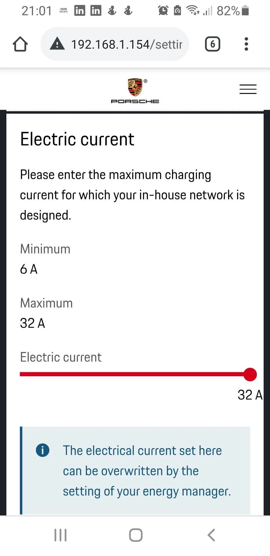

Yes the supply is 10mm cable with a 40a rcd.
I can’t find any way of changing the offered amperage neither on the display nor web app.-and this is the crux of the problem.
I’m using the commando plug cable supplied with the PMCC.
My OPC says that my PMCC won’t charge at more than 16a despite it’s web page saying it should supply 32a with no derating factors - the problem is that I can’t find anywhere to change the offered 8-16a in the display menu items nor its web pages.
Does that mean that you can achieve 32 amp charging on a single phase supply?
How did you change the 8-16a menu choice to the max 32a or was it on the app?
Thx
32A is the max on a single phase supply (it's what I have).
To be clear did you use the web interface on the PMCC (not My Porsche or anything else) using either of the 2 accounts supplied in the accompanying white envelope?
Screenshot from the Charging menu.

I’ve had the car and charger back recently -3!weeks+ in the garage and enclose my screenshot which is the crux of the problem. Says capable of 32a but only allows me up to 16a. OPC and Porsche help line unable to offer any credible explanation.
I’m a bit frustrated!
Any ideas?

Hi,
your screen suggests like the cable going to the charger supports 32A. good. But the car does not.
Which On-Board-Charger do you have? The 11kW/9.6kW will not support 32A.

Hi,
I think it is the standard 11kw, so I’m limited to 3.8kw (from experience) at best, single phase?
Why would Porsche de-rate the charger instead of letting the car charge at its max rate -which may be 16a.
Even my Honda E charges at 7.2kw!
I must say I haven’t tried charging it on a public 7.2kw charger to see how quickly it charges.

Hi,
That's rubbish (sorry). In UK single phase standard domestic supply will support a dedicated 32A run from the fuse box to give 7.4kW (I have this setup).
Therefore the standard 11kW AC onboard charger will support 32A delivering 7.4kW max.
To get 11kW you would need a 3 phase supply - expensive and not needed for home charging.

Hi,
Thanks for the (disappointing) info.
Get an electrician to check end to end as something is not correct - you should get 32A. Could be the cable, the outlet to the charger, something else which is limiting.
