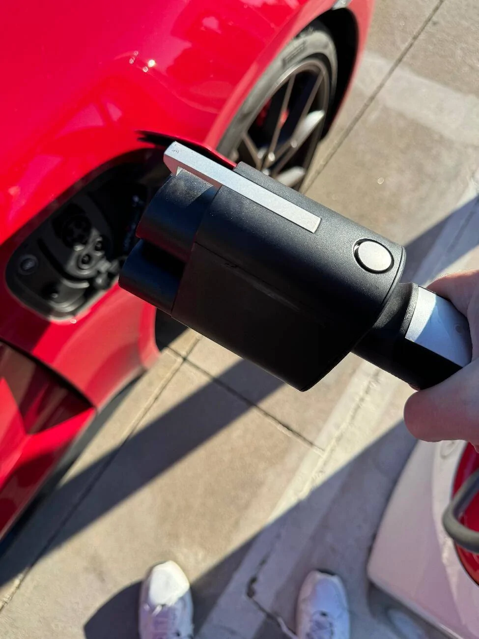

If it was the Dunkin Donuts, that site did indeed have the magic docks:
https://www.plugshare.com/location/466734
The CCS adapter comes out of the charger with the cable after you've initiated the charge in the Tesla app.
If your car has the 150kW/400V addon, you will get over 130kW.
If not, it will max out at 50kW.

I have charged at Brewster NY with the MagicDock. 150kW 😀. You need to have the Tesla App to initiate charge so best to have that already installed and set up with a method of payment.
