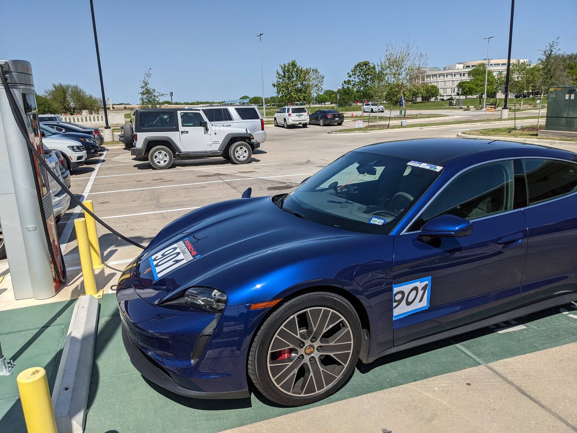

This was one of my fastest laps yesterday. My 2020 Porsche Taycan 4S (with Performance Battery Plus) is my first EV. I have previously owned two Porsches -- a 2009 911 Carrera and 2018 Macan.
This track day was hosted by the Hill Country Region chapter of the Porsche Club of America (PCA HCR) in conjunction with several other PCA and BMW CCA regions in Texas. This is my 12th track weekend at Circuit of the Americas (COTA).
In my first session, I was able to quickly get up to speed, following the line around COTA that was familiar to me from having driven dozens of laps in a 911. This resulted in a GPS-measured lap time of 2:43, only a second off of my best time in a 997.2 with stickier Michelin Pilot Sport 4S tires. I was able to pass (with point-by) several Cayman GT4s and even a 991.2 Turbo. The Taycan's power was evident down the long back straight at COTA, where I hit Vmax=148 MPH. I could also put distance on a 997.2 Turbo.
Two things happened after this fast lap -- brake fade and increased battery temperature. My Taycan 4S is equipped with the standard steel rotors, and the brake fluid is the factory fill. The brake pedal became noticeably softer, and braking distances increased especially in the hard braking zone leading up to Turn 12 where going from 148 MPH down to 30 MPH is necessary. The reduced braking power led to missed apexes in later sessions, causing my lap times to increase. I suspect the brake fluid boiled during one of the first few laps, and braking performance was reduced thereafter.
The battery temperature climbed beyond the typical 20-40°C operating range. Especially after the fifth lap, battery temperature was in excess of 48.8°C / 120°F. After reaching 148 MPH on the back straight of COTA, the temperature reached a maximum of 55°C / 131°F, based on the instrument cluster display. The battery temperature bar was in the red, and for the first time, I saw the “Drive Power Restricted” warning light:
I knew it was time to pit when the light turned on!

@daveo4EV my first session was 6 laps, including the first out lap on cold tires. By the 6th lap (i.e. 5th hot lap), I hit 131 degrees and it was break time. I consumed ~9% per lap. Computer showed 1.1 kWh/mile, which is about right given COTA's 3.4 mile length.
Closest DC charger was 8 miles away at the Austin airport. It's a 62.5 kW ChargePoint charger, and I spent most of my HPDE day there. It worked out to be 3 minutes of charging for every 1 minute on track. However, with <90 minutes between sessions, I could only get ~45 minutes of charging. Thus, I'd come back to grid for my 2nd and 3rd sessions barely above 50% SOC, meaning I could only do 4 laps. I'd arrive back at the DC charger ~5% SOC!
I have the 20" Michelin Pilot Sport 4 tires on the Taycan 4S. I had MPS4S on my 997.2, and I could definitely tell a difference. This video review nails it. The car really started pushing during the 2nd & 3rd sessions, and my tire pressure went from 31 psi (grid) to 41-42 psi on track!
The brake fluid was cooked by lap 5 though. I felt a spongy brake pedal afterwards, and I was just a little too spooked to do deep braking + late apex like I would have in my 911. I need to re-learn how to drive in a car of this weight!
It was a fun day in the sense of lapping a new car around a familiar track, but I'm itching to get back into a Porsche sports car for HPDE days. The Taycan was definitely competent on track, but it was like wearing Converse All-Star shoes to run around the track -- you could, but it just wasn't natural!

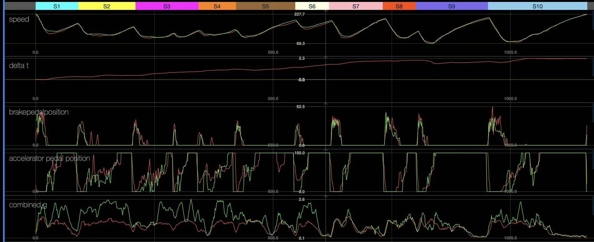

here is a comparison of Rob's data vs. my data @ Thunderhill this past march - Robb is 2.3 seconds faster than I am in the same car, same tires, same track…but I'm super close - it turns out Robb is just that little bit better than me all over the track - an that minor margin adds up to 2.3 seconds across a 3 mile lap…
Robb is the "green" line - the "faster" lap - I"m the "red" line the slower lap…
I'm a 55 year old hobbyist trying to match a life time carting/racing champion - I'm quite pleased I'm even this close…
this is a 2018 911 GT3 - street tires…
here is the video the match the data for this lap (red line on the graph)

@daveo4EV Great videos! Robb definitely has an efficient line. His turn-in points at COTA T11, T12, and T15 are much earlier apex than I've been taught, but it's possible that's the difference between a pro and what's taught to an amateur! The input traces are similar to what I've been between myself and much better drivers ... smooth, but more forceful / decisive inputs whereas I'm always a bit more tentative especially on braking zones.
I'd love to see a hot shoe set reference laps in a Taycan on American racetracks. I wonder if it'd frustrate / confound them coming out of a rear-engine, lightweight RWD car into a 50% heavier AWD EV like it did for me?! :CWL:
So amazing that you had a Cup entry! Did you learn / get your license at Barber Motorsports Park with Porsche Track Experience?
