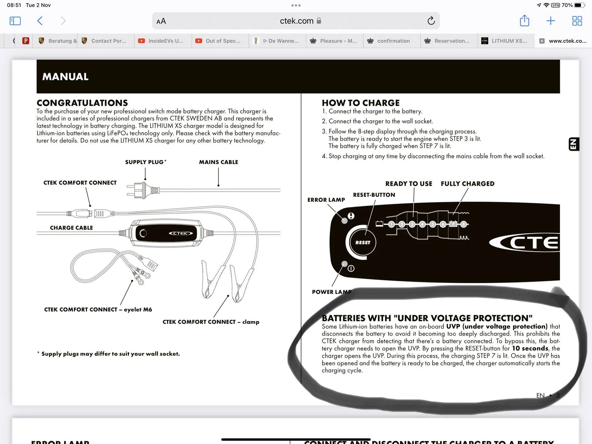

Just to add to the discussion on whether the CTEK can help out when the 12 volt battery protective relay has disconnected the 12 volt battery. The CTEK has a feature that seems to boost the voltage to address this issue, at least here in Europe. Here is a copy from the CTEK manual.
Porsche Taycan Problems with trickle charging 12 volt battery 8475C3EF-B113-4BBD-94D3-372CF1D8FD2E
I have never tried to actually Use this feature though, so can not comment on this feature.
The same information also appears in the US manual. Honestly, I had just skimmed over those particular instructions prior to this discussion and your post prompted me to go back to the manual for a closer look. Seems like this could be a useful feature. Thanks for your post!
