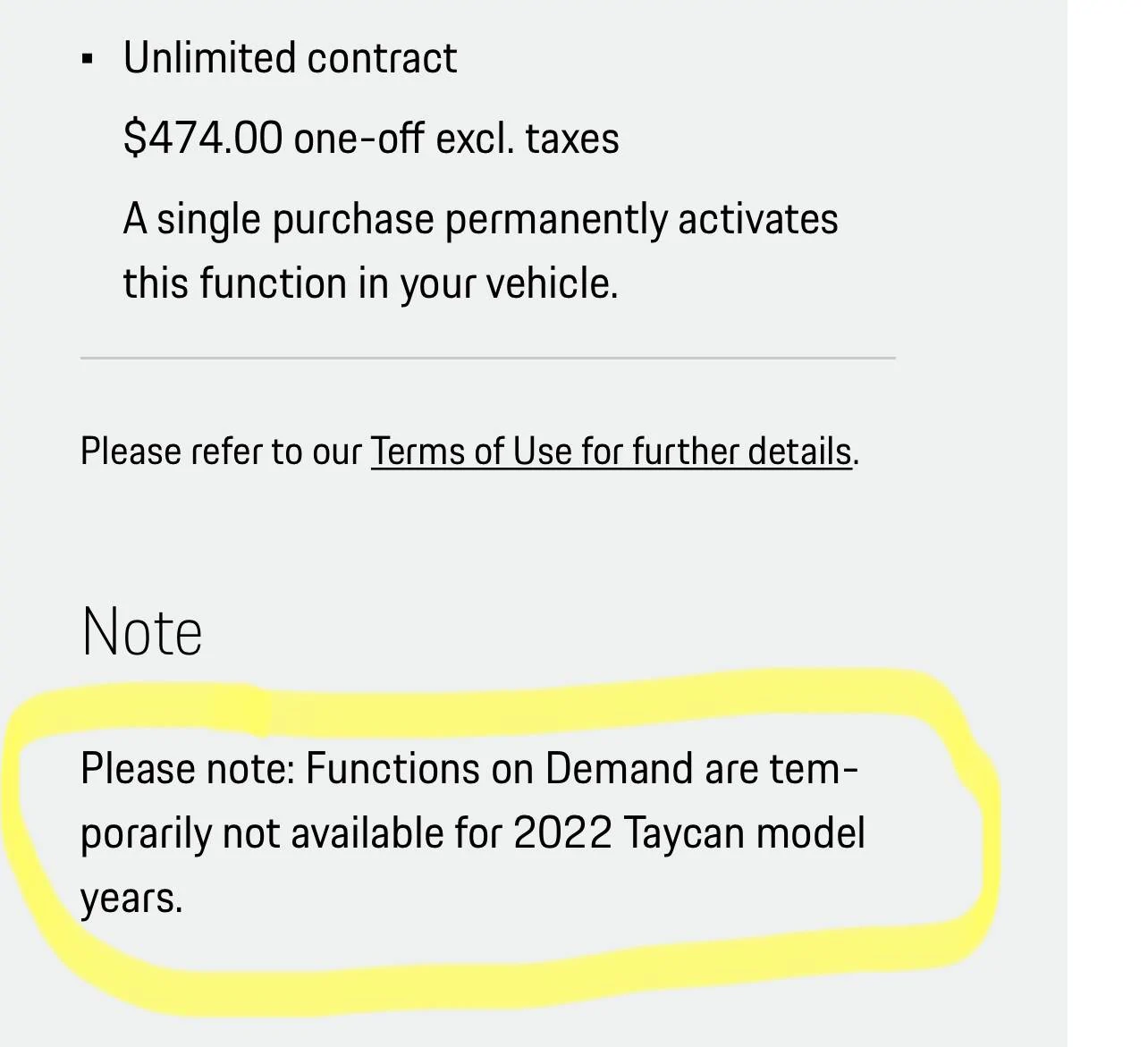

I suspect this may only be for MY22 cars? I still see an option to purchase PIRM as an FOD on my MY2020 (although I haven’t tried doing it to see if it goes through) but I also see this note on the purchase screen.
Porsche Taycan Purchasing and adding features via.. Function On Demand B0B5C6D7-D5B4-4F51-9D4D-80BB7F967680
11,049
6,835
Indeed but no explanation as to 'why'.
