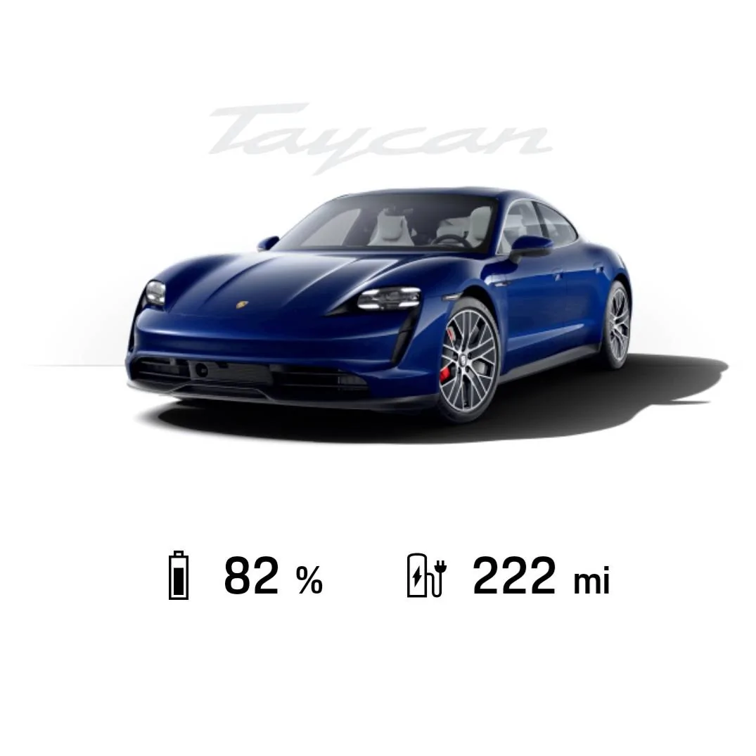

Hi guys,
What is the range you get with %85 battery for Taycan 4S Performance plus in normal mode with city driving?
It's pretty consistent between 225-230 miles at 85% for me. I also have a 4S with the Performance Plus battery, and generally only drive around town in Normal mode. I just looked at the app and see this:
Porsche Taycan Range with %85 battery for Taycan 4S Performance Plus Screenshot_20230613_094130_My Porsch
