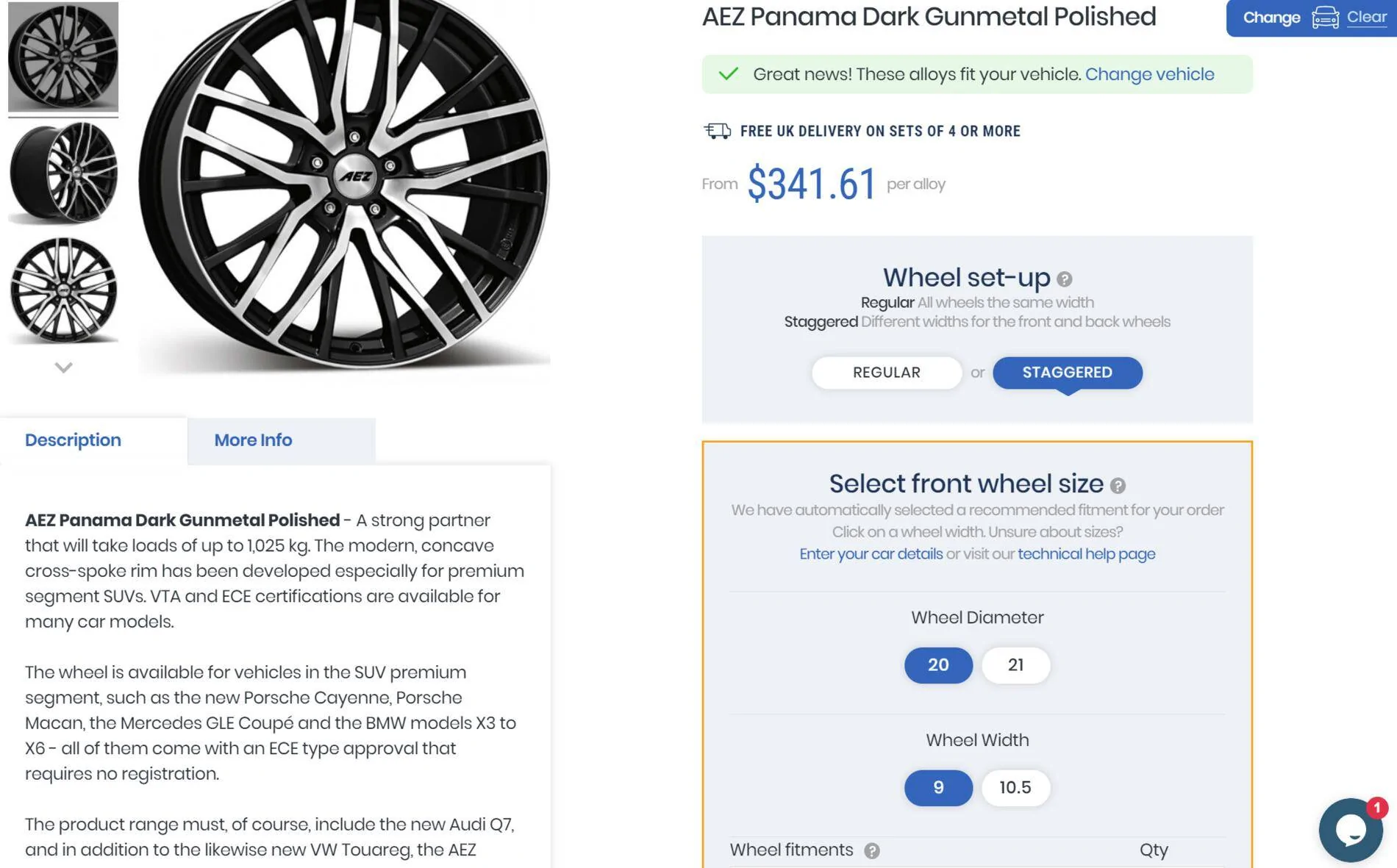

And the parameters are: AEZ Panama Dark gunmetal polished
Fronts: 9.0J x 20 ET 50; center bore 71.6, bolt pattern 5x130
Rears: 10.5 J x 20 ET 64; center bore 71.6, bolt pattern 5x130

Thanks! I just might copy you and get the same. Right now, Performance Alloys' website crashes when I put in Taycan where you select your car. And it asks me whether or not my car is a "Y1A" model, I don't know what that means. I emailed Performance Alloys, hopefully they'll fix it.

Search them by brand (AEZ) and model (Panama). Select then the staggered setup
Porsche Taycan Ready for winter 1603275740067
