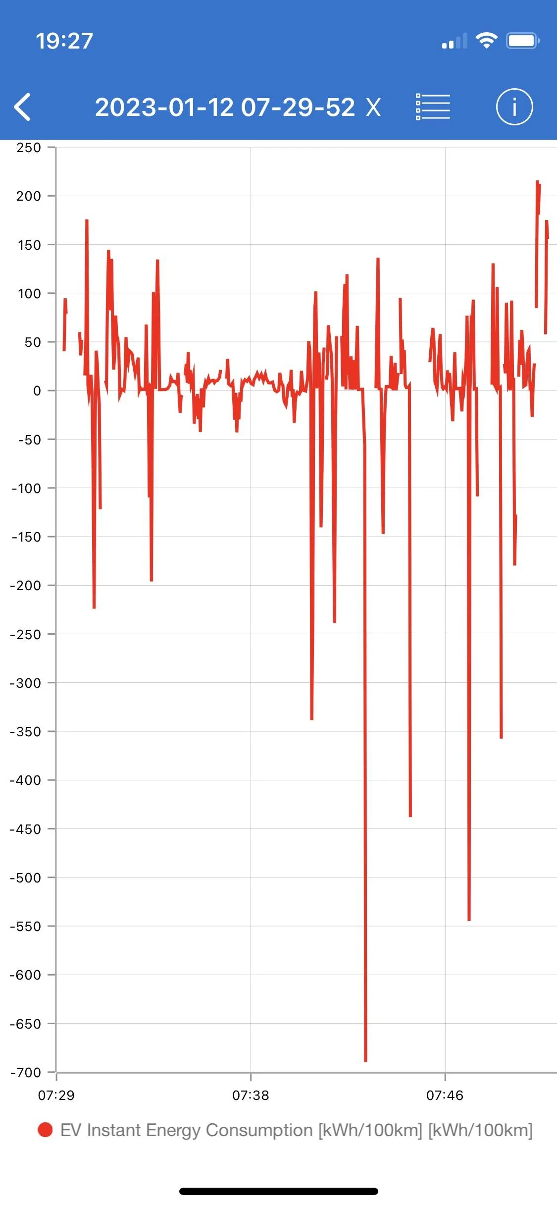

You can see instant energy consumption in the carcanner app and you can log during driving:
Porsche Taycan Realtime consumption meter 1674412137671
