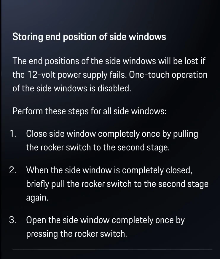

Window in rear door does not travel all the way up when door is closed. It actually travels too low when door is opened and that may be the reason to why it doesn't go all the way up. To have it closed, I need to manually close it. Anyone know if there is a known issue and, even better, if there is an easy fix? It does not give a fault message readable from the ODB port.
