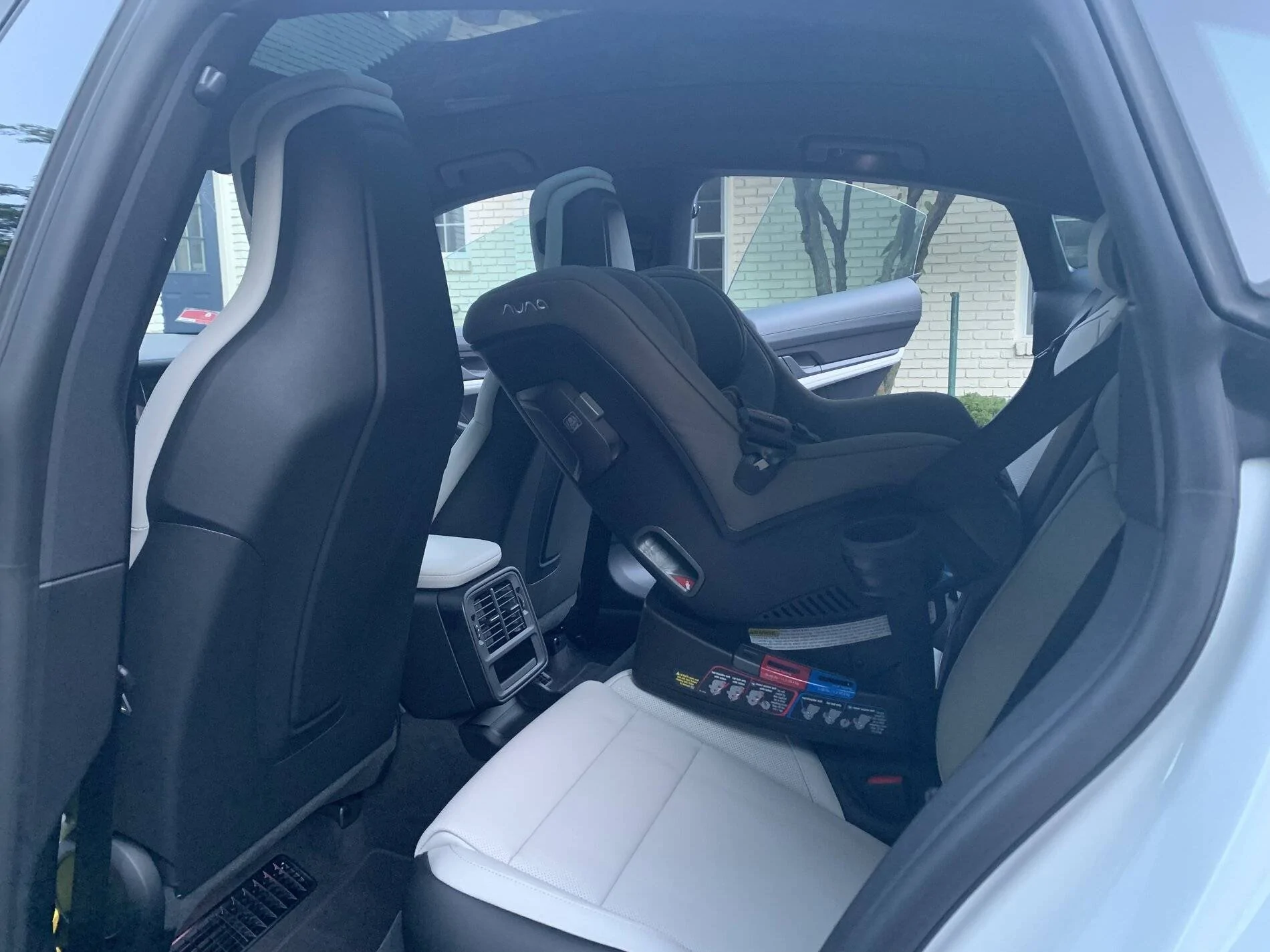

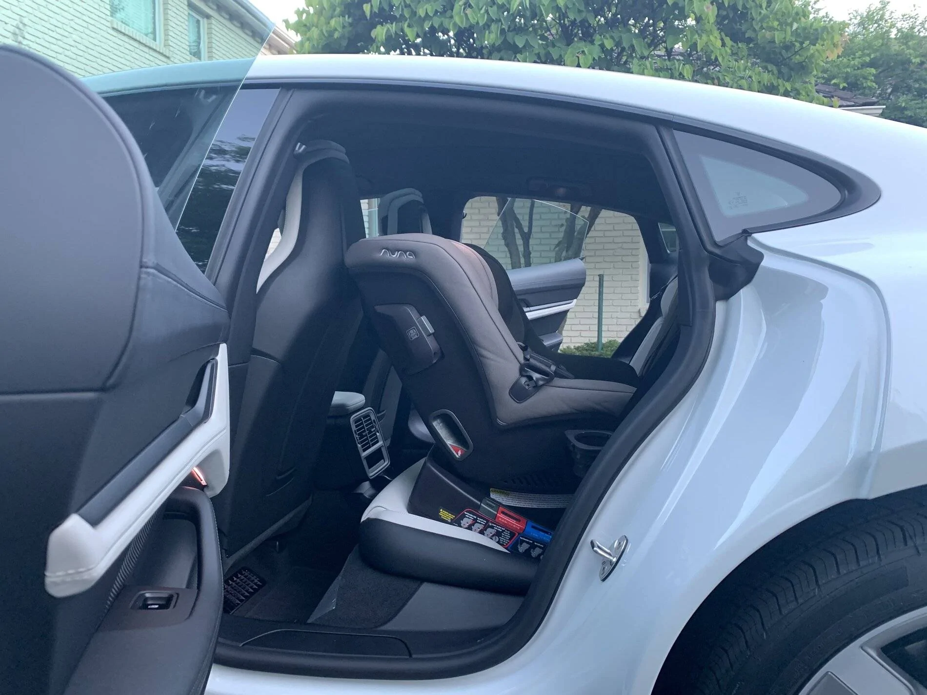

Currently have a Nuna Rava rear facing. It fits, but your concern for the seat angle resulting in a more upright seating position is valid. If my child were younger with less head control I would avoid it. I haven’t tried yet but the middle seating position may have less of an incline compared to the outboard seats thereby alleviating that issue. Can try to take pictures if you’d like.

If you could do that, that would be amazing! I didn’t realise the middle seat has a LATCH / ISOFIX system, I thought it only has a belt?

You can see the angle in a rear facing seat is less upright in the center seat. However the center seat placement doesn’t seem as secure compared to the outboard seats, probably owing to the shape of the middle hump. Also the middle seat does not have isofix anchors, but it does have a rear tether for forward facing installations.
Porsche Taycan Rear facing baby seats? EB305304-1C7C-4AED-9BC8-0EF560C0AE39
Porsche Taycan Rear facing baby seats? 9654DFFD-27FC-4DCC-9B11-6B270D71B3F3
