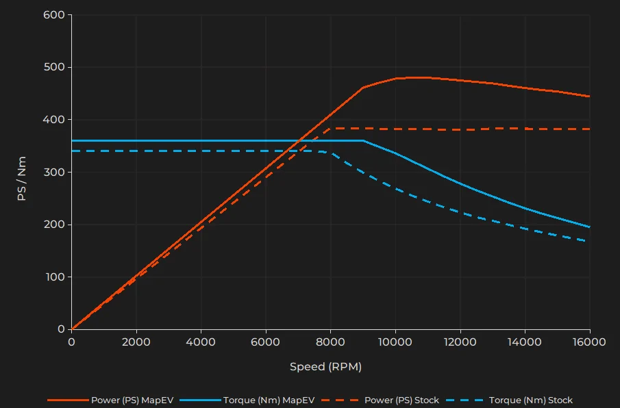

The gearshift is at ~130km/h. Majority of the difference is above 60km/h. It accelerates 25% faster after that. So if your 100-200 time is e.g. 14 seconds, you would expect around 11.5 seconds with the tune.
I don't think I have actual Dragy measurements from a RWD, but we've done quite a few and people have been satisfied with the result.
Maybe this graph is more interesting:
I'd say the difference is fairly significant at higher RPM. It shifts at 125-130km/h with the tune, which is around 15500 rpm on the chart, and after the shift is complete you're right at 8000 rpm again, where you have the extra power.
Depends really how you drive it, if you just drive it around town, then there's not much to it, but out of town there is significantly more performance for overtaking and merging onto the highway.
Just depends on your usage I guess :)
Isn't this just the power with launch control? The PB+ RWD comes with 469hp when in lauch control from the factory and that looks like the graph above. So your tune will essentially allow access to that power outside of launch control?
Yes, exactly the car runs maxed out in launch control from factory, and we allow it to enter launch mode any time the throttle is floored (even while moving).
The standard launch control is not terribly useful when overtaking or merging, or in fact in 99% of driving situations.
