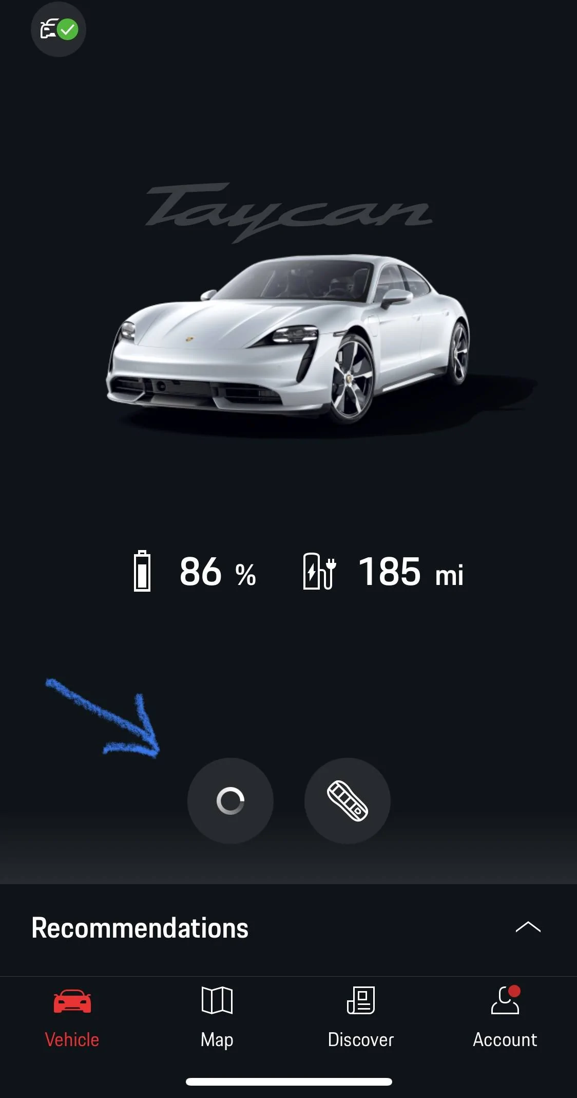

So, I recently took my TT in for a couple of software updates, but now my remote climate control function with the MyPorsche app doesn't work -- the button just spins (see screenshot). I've reinstalled the app (didn't fix it), I've reached out to my person at the dealership (they weren't helpful), and I've searched this forum but couldn't find anything (famous last words, I know ...). Has anyone encountered this problem? I am in Boston and would love to pre-heat my car given the temperature. Thank you, in advance, for any tips (including if I have somehow missed the thread on the topic, which is possible).

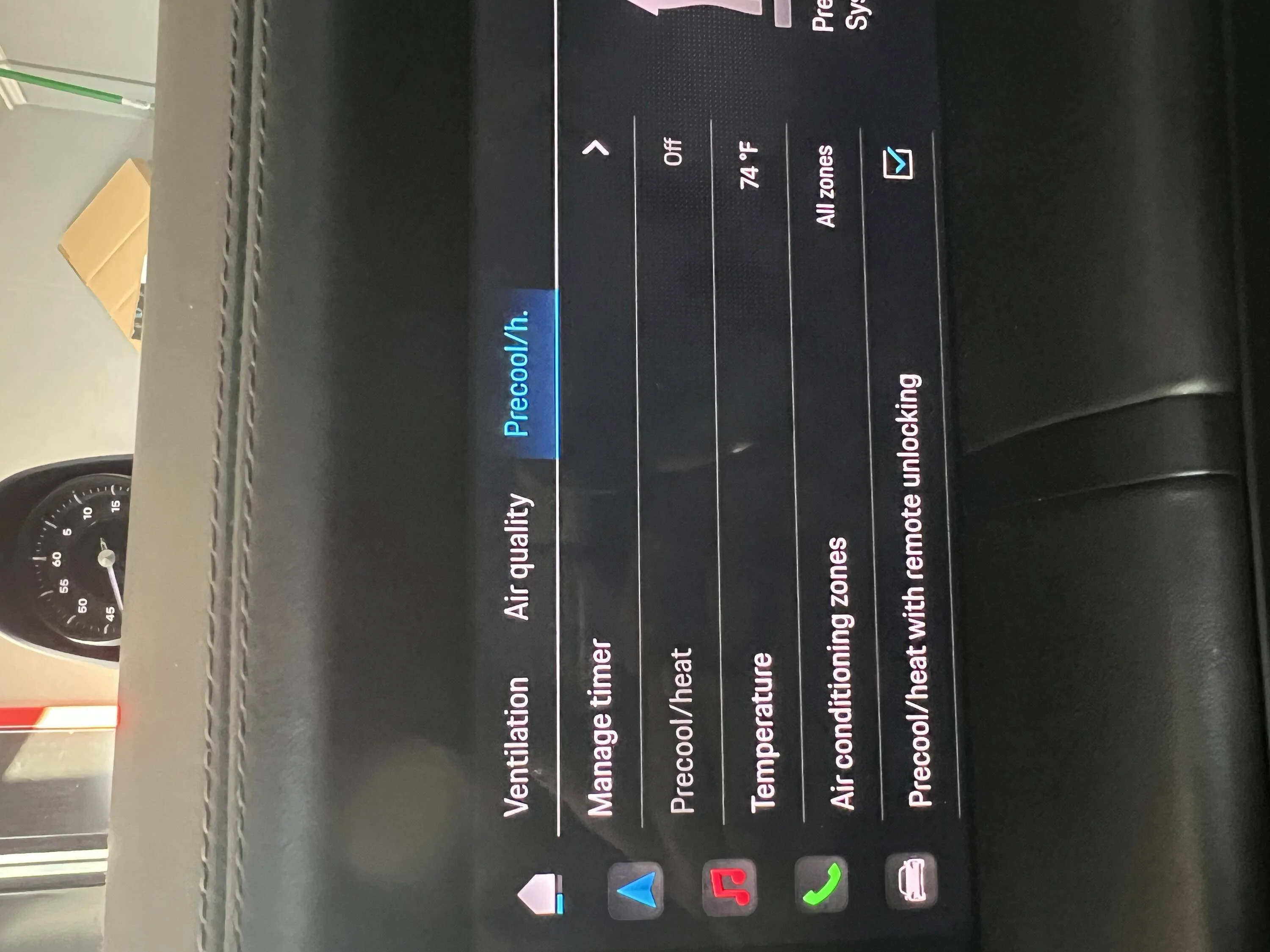

Can you manually start pre-heating, in the car? Does the cabin heater work when you drive?
In some cases, it spins, but heating start to work anyway.

Great question. I just went and checked and it looks like the answer is no. On the upper screen it the precool/heat is set to off (see image ... sorry for the rotation) and it cannot be activated. To the right (which didn't get full captured in the image) it says that there is a systems error. I guess I have a bigger problem.

Yes. I had the same error message. Required electric heater replacement. Check the many threads on forum about heater problems.
