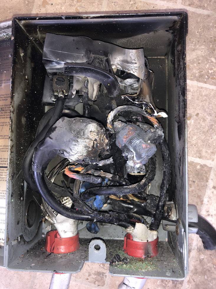

this electrical circuit worked flawlessly in my attic for 7 years - until one night it didn't - almost causing an attic fire - subsequent investigation lead to the discovery that inappropriate gauge wire had been used for the 60/48 amp load - and the years of multi-hour charging session eventually caused the wire to fail
I'm glad it didn't burn the house down.
