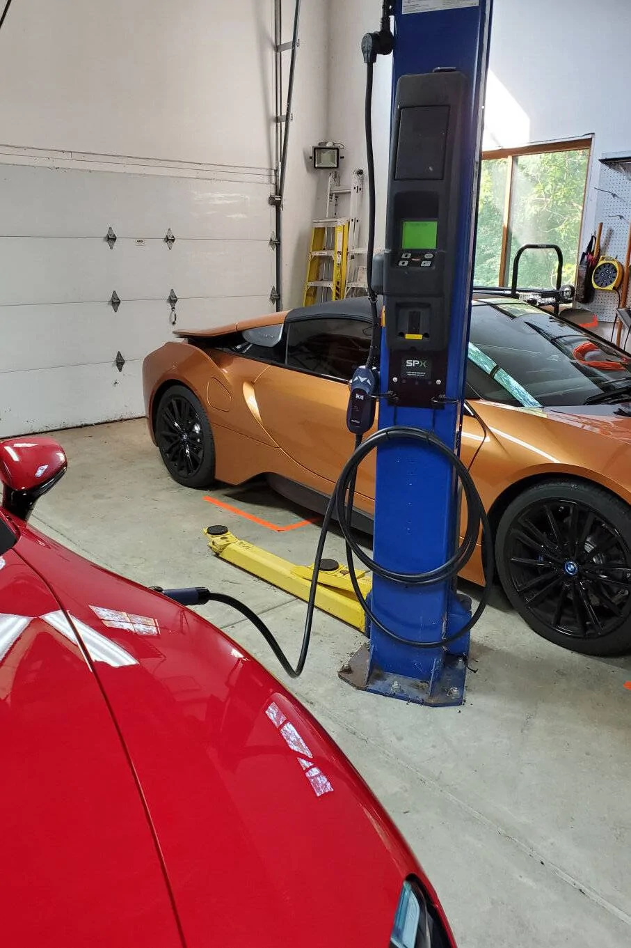

Here are the photos I went to take. Here you can see my charger right next to my car. Note that the charger cable goes straight up towards the ceiling:

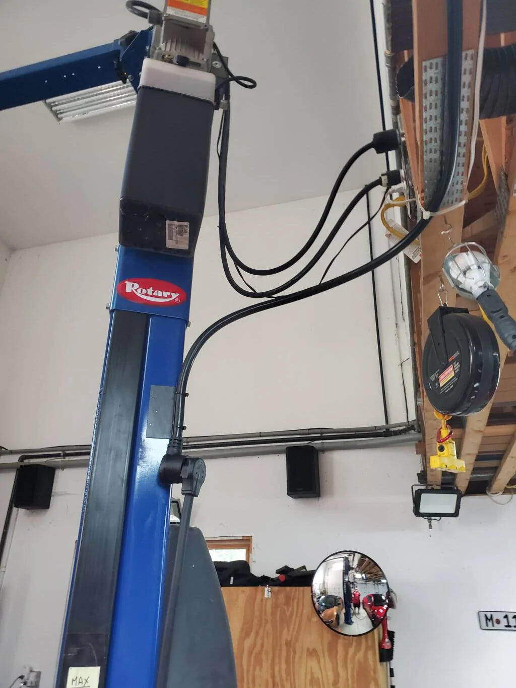

..and her is looking up at the ceiling. You will see the extension cord running along the joists and the connection between the charger cord and the extension cord. The charger is completely removable in this way.

If you don't have something to hang the charger from, you could actually hook the charger itself and the cables right to the ceiling with some large screw in hangars. Everything would still be removable if that is what you want. Two hooks to support the weight of the charger and one hook to loop/hang the extra charging cable. Unplug from your extension and go!
Here's some examples of the type of hooks I mean:
https://www.amazon.com/StoutMax-Heavy-Duty-Storage-Hooks/dp/B01MZH5E7B
Does this help?
