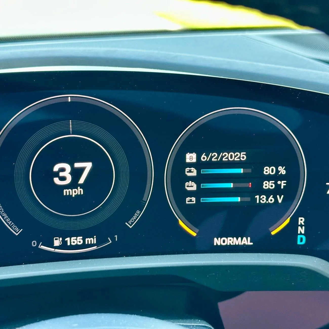

I have had my CPO 2020 4S for just over a year, and in that time I have never had a single issue. I charge at home with a Wallbox installed by FPL (Florida Power & Light) and until recently an 80% charge always gave me range of 205 miles, give or take a few.
I went out of town this weekend and left my car at home, and this morning when I got in it was showing me a range at 80% charge of only 155 miles! I don't know if a software update caused this, because nothing else has charged since I left it on Friday. The weather here hasn't drastically charged - Lows in the 70s and highs in the mid 80s.
I'm baffled as to why I've suddenly lost 25% of my range, seemingly overnight.
Any ideas before I call my service advisor?

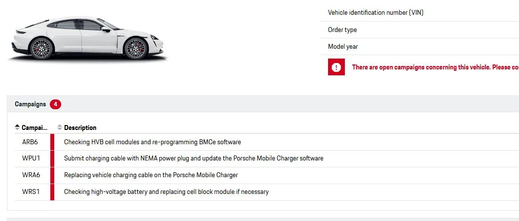

Feel free to share your VIN Number in DM and I will check in PCSS whether your car is affected by WRS1.

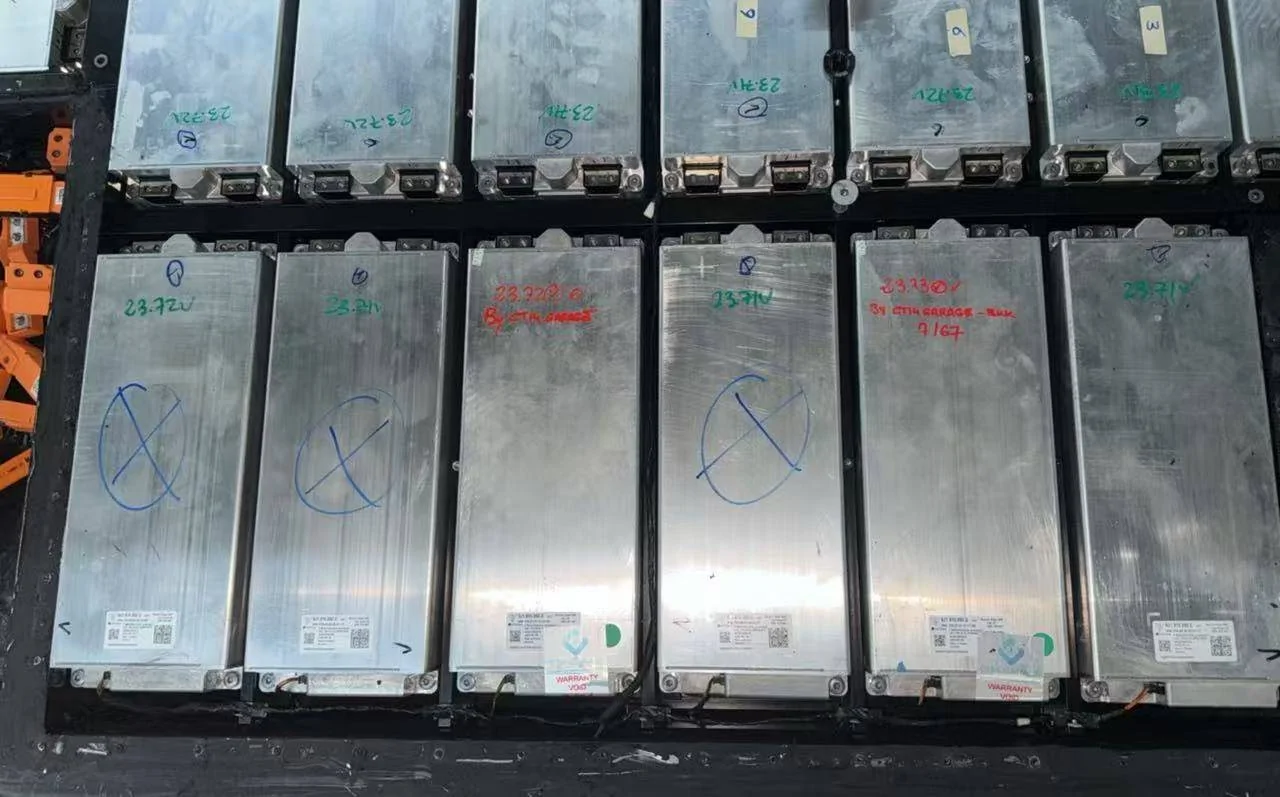

But as I replied on Facebook to you, I'm 99% sure this is the beginning of a WRS1 failure in 2020 Taycan. They all start this way. Almost every week we repair one car with this problem and they all start this way.
At least 1 out of the 396 cells in your battery has dropped voltage, causing a big difference in voltage to the other cells (called voltage delta) which causes this sudden drop in range.

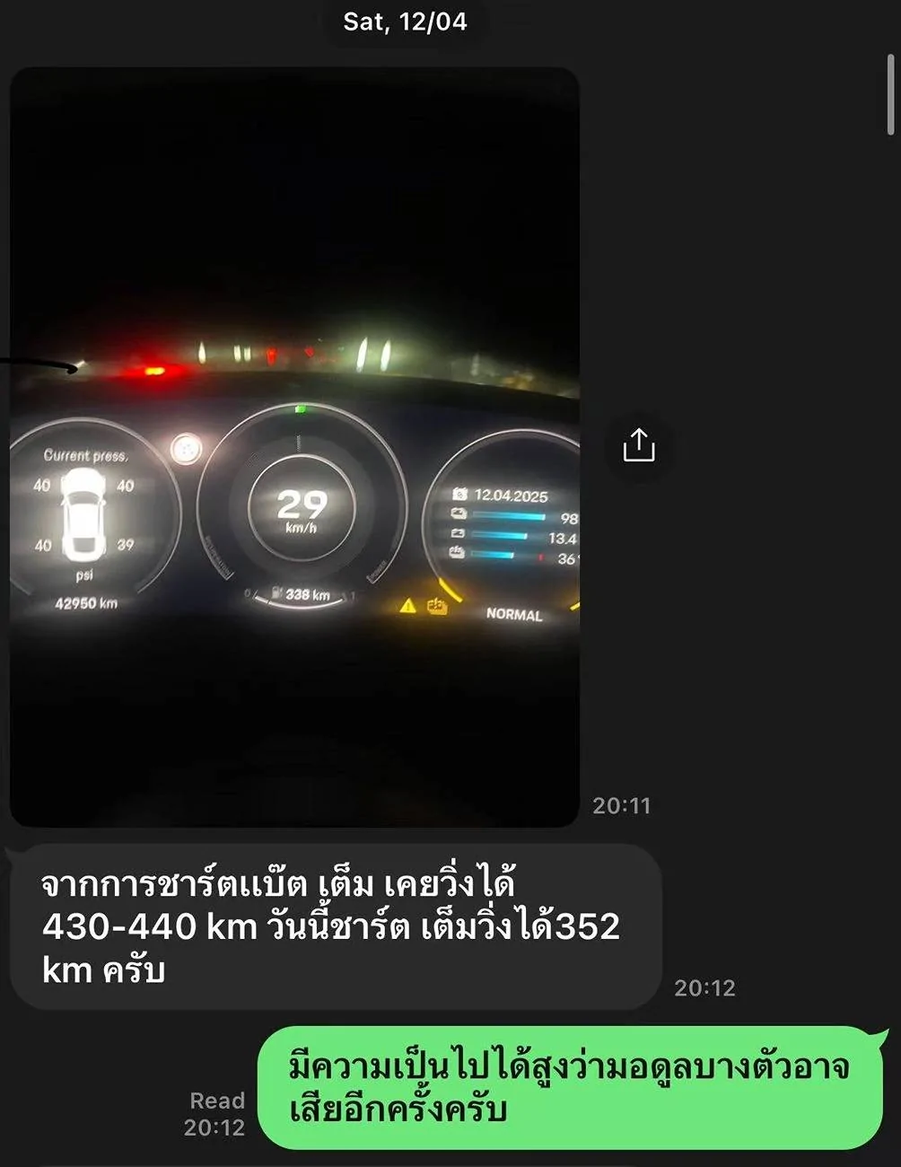

Here a customer enquires to us that his 2020 Taycan suddenly drop range from 430-440km to a mere 352km when fully charged.
Porsche Taycan Sudden 25% Drop in Range 1285e164a50e48135baf080e9d6e228
Booked him right away to repair the battery..... 3 modules down
Porsche Taycan Sudden 25% Drop in Range 15b4504b900e2c858831b72f0c7af68

Thanks for the info. I had my car in for recall service last fall and they checked the battery for this issue and told me it checked out. Since it is still on a CPO warranty I will drive a few days more and if the status doesn't change, I'll call them to set up an appointment for further testing.

Yup. As I presumed your car is affected by WRS1 and the dealer weren't even bothered to check it during last visits. So now you know the cause
GRRRR, time for an angry phone call! ;-)

I have never really looked at consumption to be honest. But nothing has changed weather wise or in the way I drive it, just that I left it for the weekend, charged when I got home and this. I have a service scheduled so I guess we'll see what they say.
