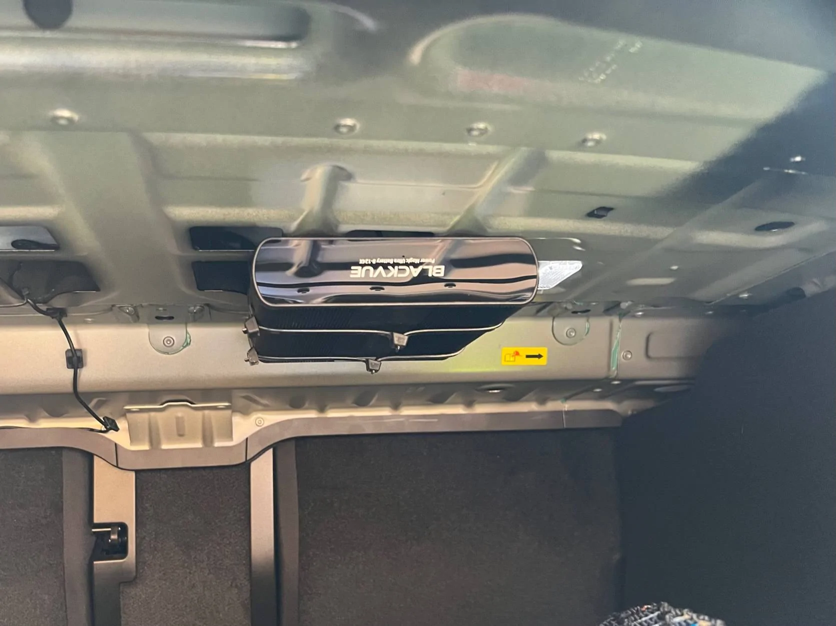

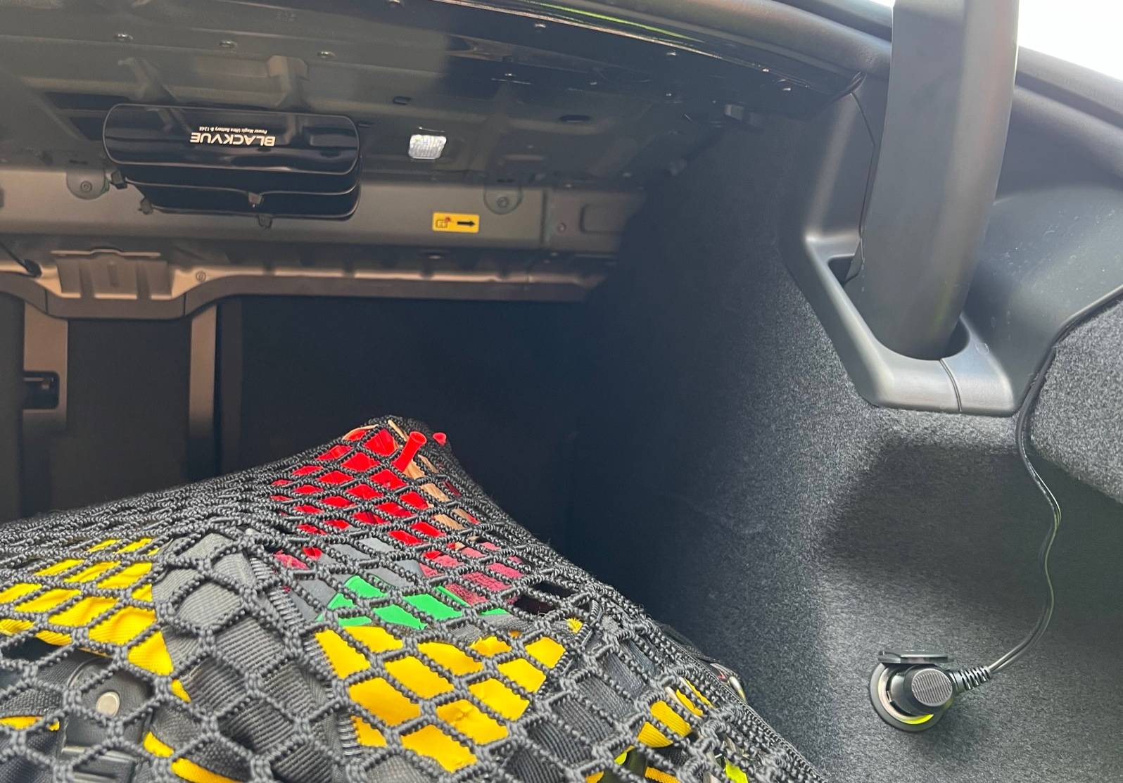

Is the cord long enough to run to the front camera?
Yes the cord is long enough to reach the front camera
Porsche Taycan Switched fuse (acc) IMG_5296 - Copy
You can see the power cord in the background heading behind the rear seats , then to the left and then up into the edge of the headlining through to the front camera
Porsche Taycan Switched fuse (acc) IMG_5298 - Copy
The zip ties I had to hand weren't actually long enough so I've connected two together which is against my OCD-religion and I will replace shortly. The battery has not moved at all in 1500 miles of spirited driving
