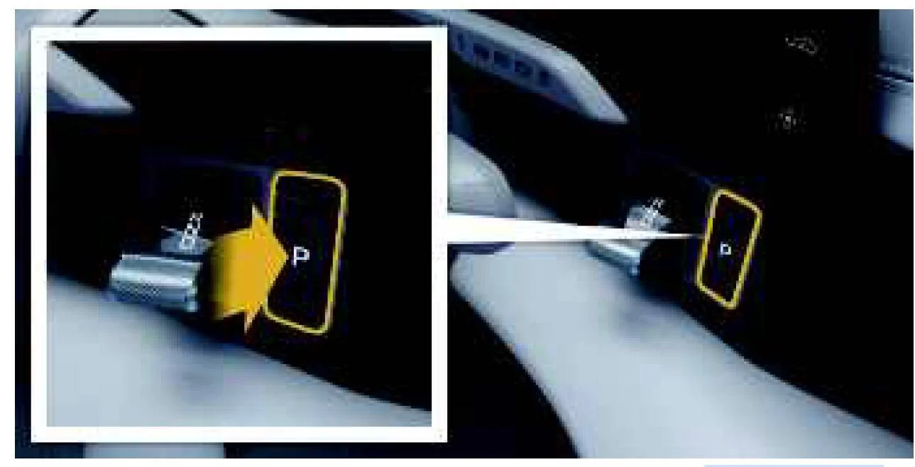

Hello,
You said that your car has the handbrake engaged so did you had the following
Porsche Taycan Taycan 4s parked on snow rolling forward - how why and wtf?? 1609263858045
symbol on bottom right of your instrument cluster after pressing the Electric parking brake and parking lock
Porsche Taycan Taycan 4s parked on snow rolling forward - how why and wtf?? 1609264128371
? My advice is to try again and check if you get the symbol
coming when you press "P".

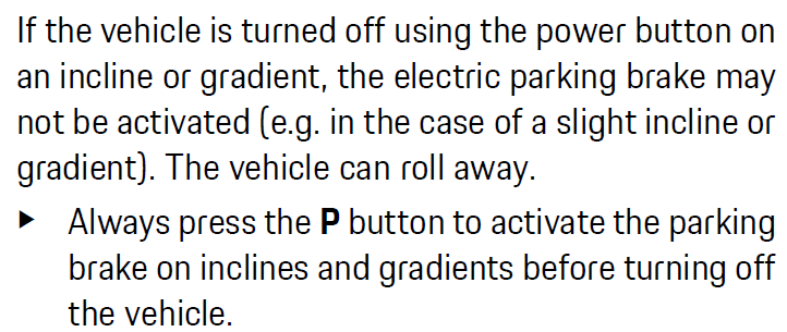

For everybody be careful to press "P" when you left your taycan, as investigating this case I found out the following in the manual
Porsche Taycan Taycan 4s parked on snow rolling forward - how why and wtf?? 1609264592572
I checked it on my Taycan and it's "right" if I switch off using the power button then the symbol
does not appear. (it appear only if I press "P")

Here is some reference from Good to Know.
so really surprising if the Parking Brake and the “parking lock” have engaged properly
Activating the P transmission range automatically
Hold the vehicle stationary by pressing the brake pedal.
D or R transmission range selected.
  • Open the driver’s door and driver side seat belt.
    The parking lock and the electric parking brake are activated automatically.
    The brake warning light and the P transmission range display light up on the instrument cluster
    – or –
  • Switch off the vehicle using the power button.
    The parking lock is activated automatically.
    The P transmission range display lights up on the instrument cluster.
    The parking brake is also activated when parking the vehicle on inclines and gradients of over 8 %. The brake warning light
    Porsche Taycan Taycan 4s parked on snow rolling forward - how why and wtf?? 1609269643071
    lights up.
