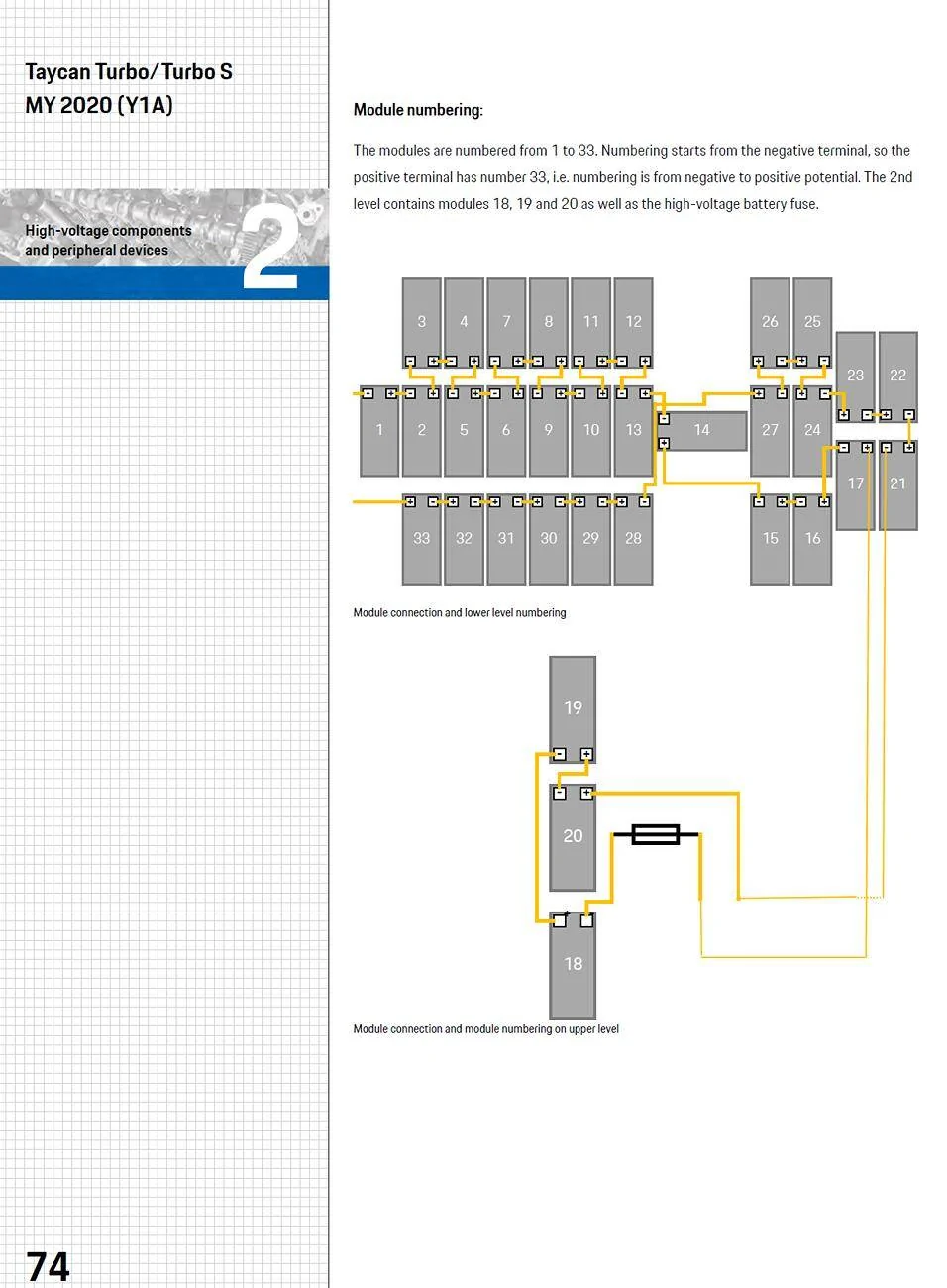

What made me skeptical only few minutes into the video is the comment that in the PB battery all modules are in series, while in PB+ some are in parallel. In fact, all modules are in parallel in both PB and PB+, and each module contains 12 cells in a 6s2p configuration, so the result is 198s2p (see below). The PB battery has 168s2p configuration, and yes it has a lower output voltage, so the expert is wrong here. The comment about Ohm's Law made by the host was funny (Ohms law has nothing to do with connecting batteries in series or parallel), but I give him a pass, he's the host, so like any other journalist trying to sound smart by throwing loosely related terms around.
Some reference materials for those interested.
I added the thinner yellow lines above to clarity how the upper level modules 18,19, and 20 connect between module 17 and 21 on lower level.
