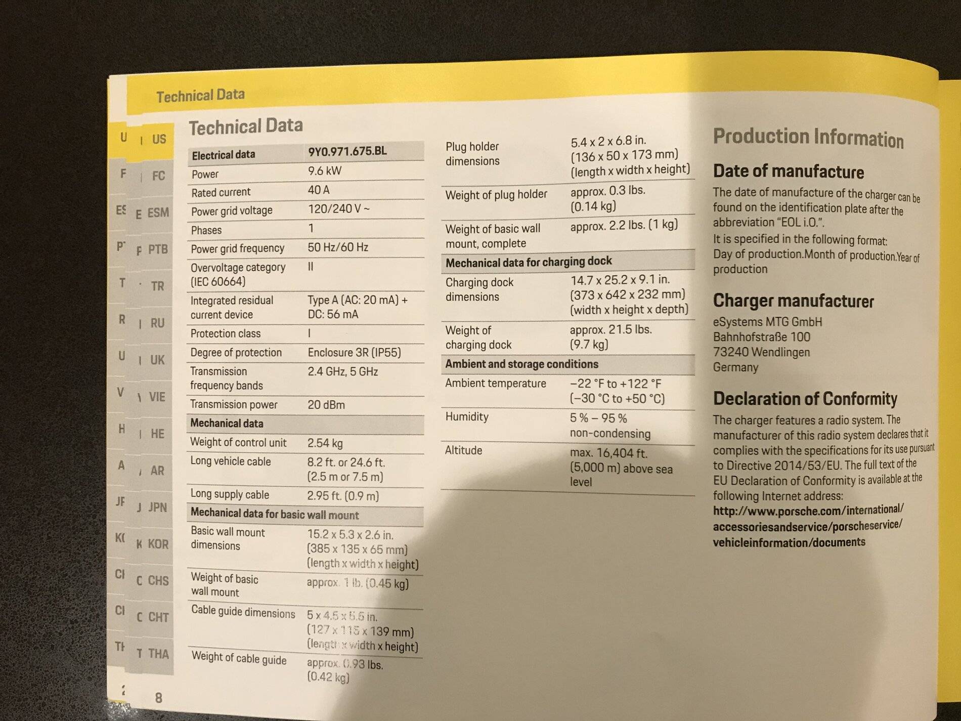

Hello everyone! So excited to be getting my new 2021 Taycan at the end of the month! I’m scrambling to get my charging station ready in my garage. I’m looking into buying the charging station dock. Does anyone know the dimensions of the unit? Also, I found it available for a little over $800 from Suncoast Parts, but it states there are different versions. How do I know which one to get?

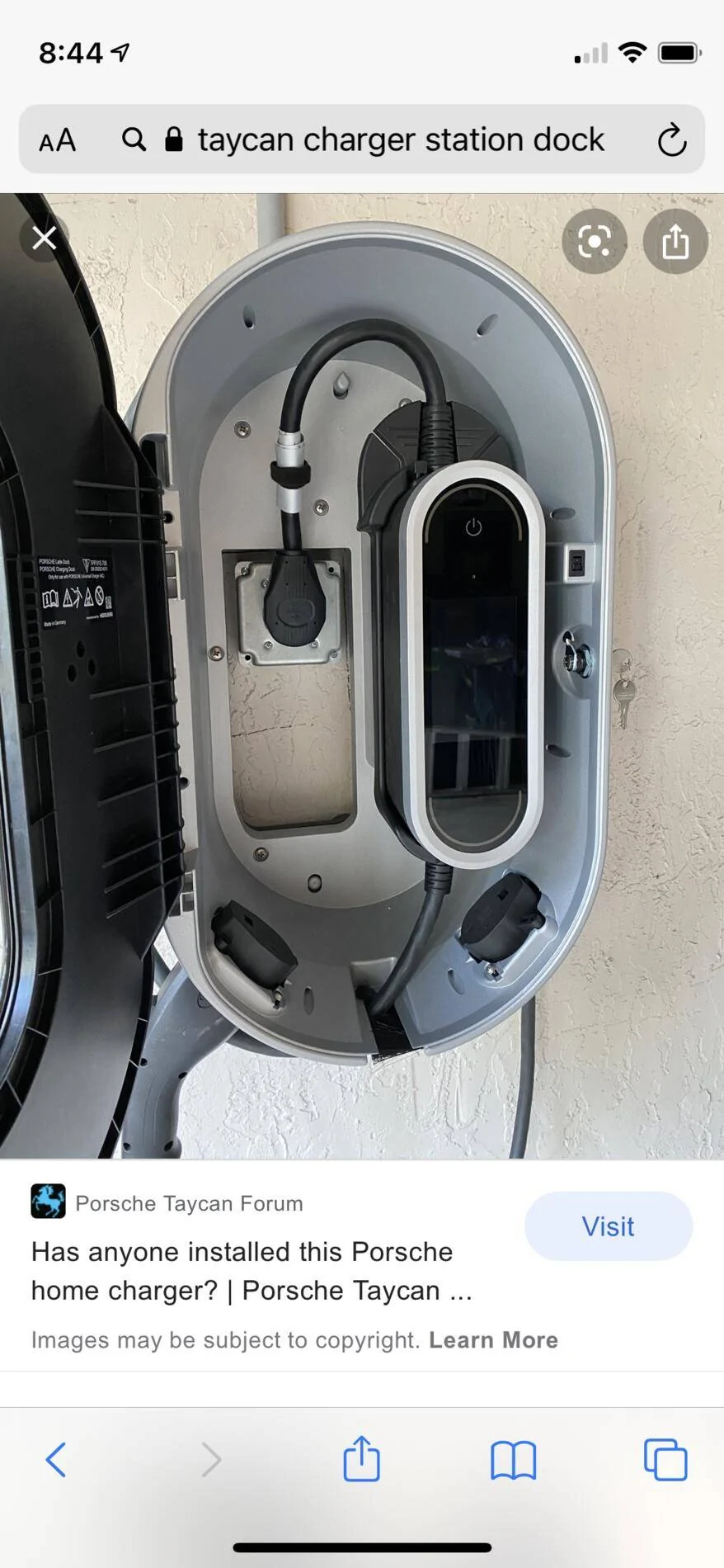

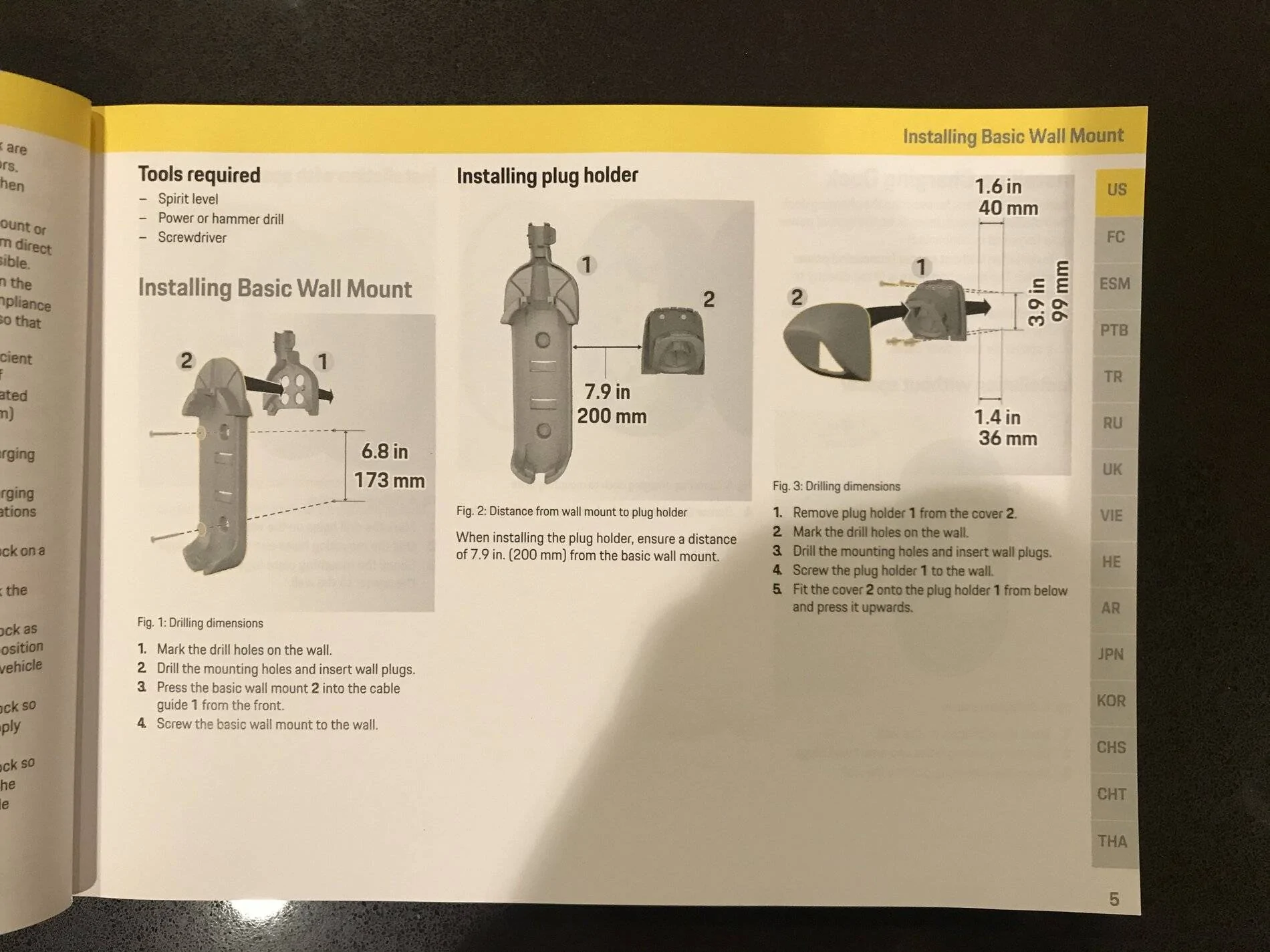

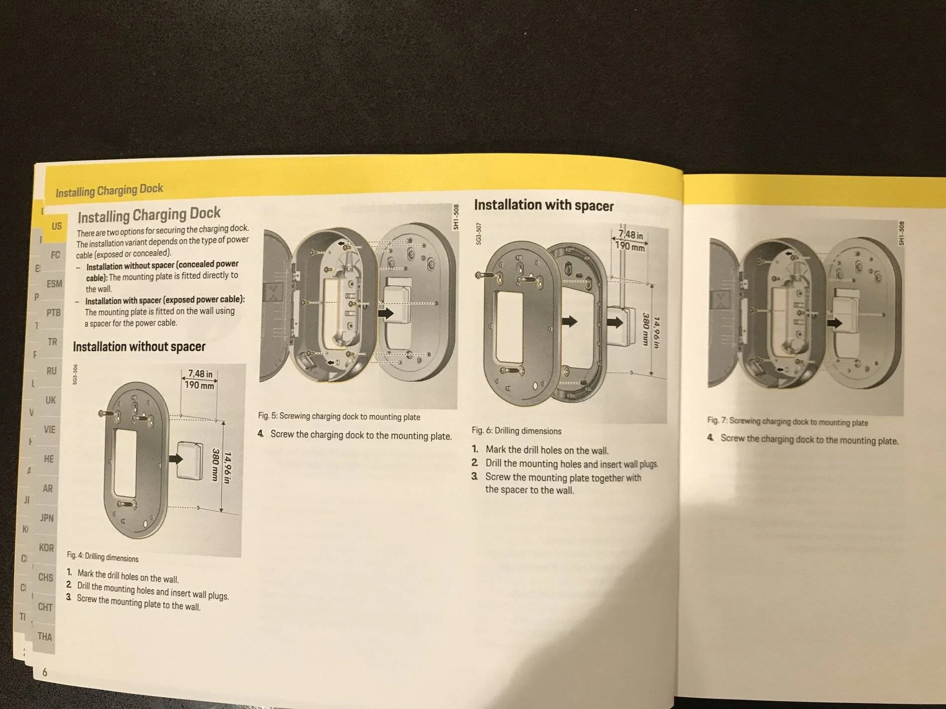

I installed my own after having the outlet put in. It was super easy!!!
1) Bolt on the flat mounting plate onto wall.
2) Attach the charging dock housing onto the plate
3) Just make sure the electrician puts the plug the right side up. The round part of the plug on the bottom. Otherwise you will struggle to plug it in because not enough room to turn plug around.
