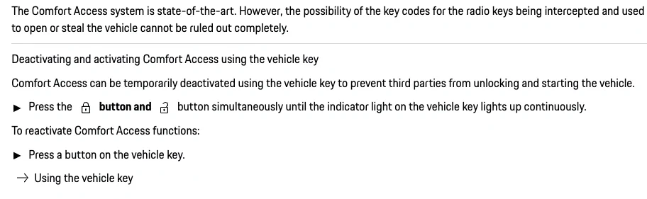

Keep the key fob > 6m away or until it stops flashing. A Faraday pouch is another option.

Press the lock and unlock button on fob at same time, for about a second until the red light on fob flashes once.
