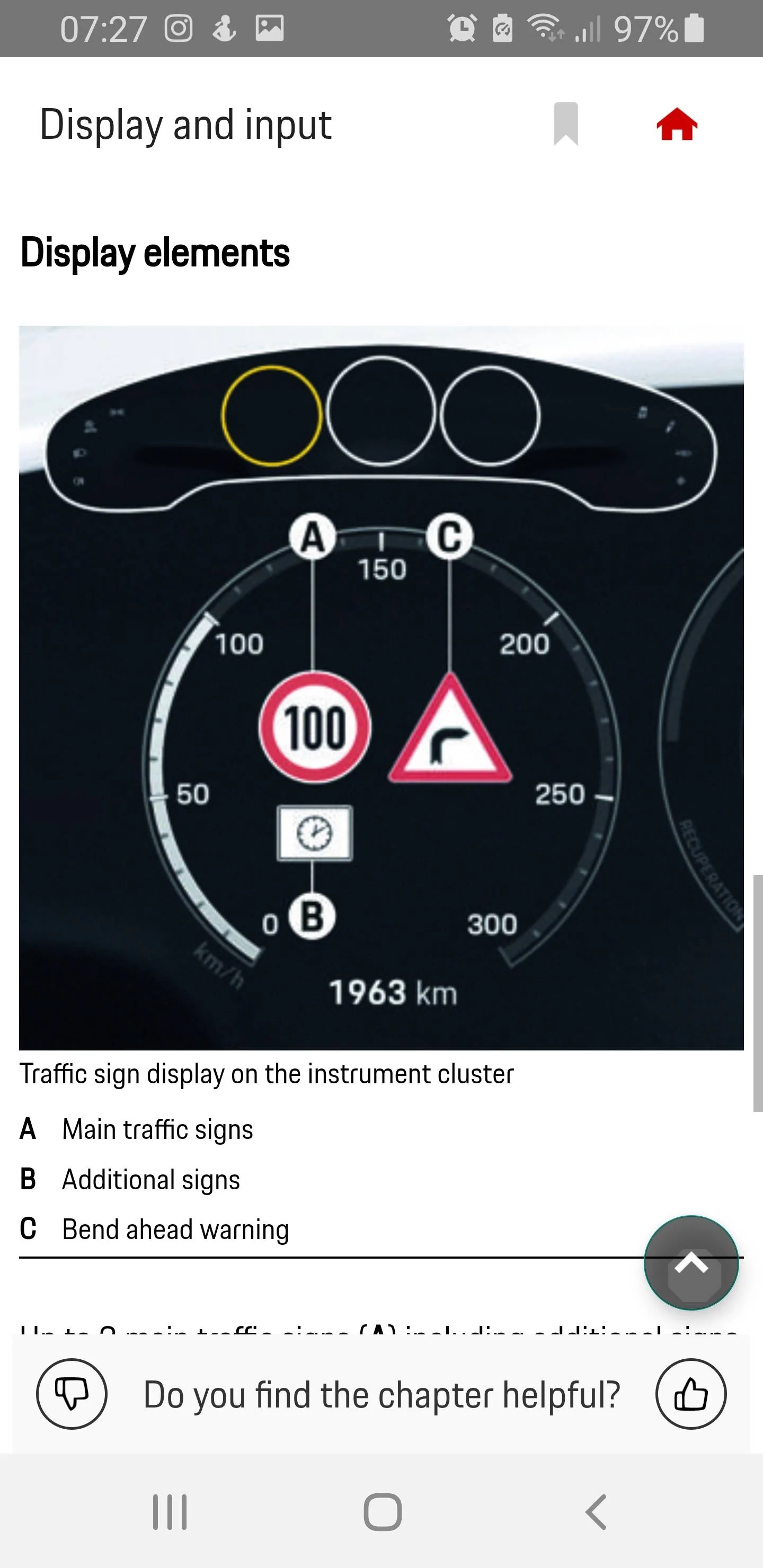

It doesn't display on the PCM.
It should display on the digital cockpit - main dash - on both the centre and left tubes and is always displayed in the centre one alongside power meter, map etc. On the left one you should be able to scroll to Traffic Signs.
Check Porsche Good To Know App.
Basic question but I assume your car has a camera installed at the top of the windscreen (STD fit normally)?

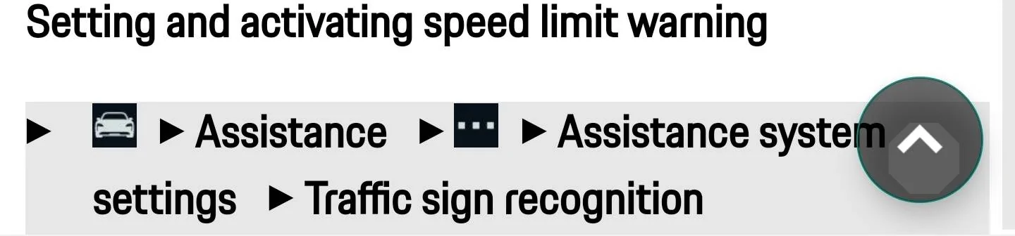

It could be this feature is also disabled in UAE (can't imagine why) as it is country dependent.
Check PCM settings
Porsche Taycan The speed limit recognition doesn't work ? Screenshot_20220917-072532_Porsche Good to know
Porsche Taycan The speed limit recognition doesn't work ? Screenshot_20220917-072715_Porsche Good to know
