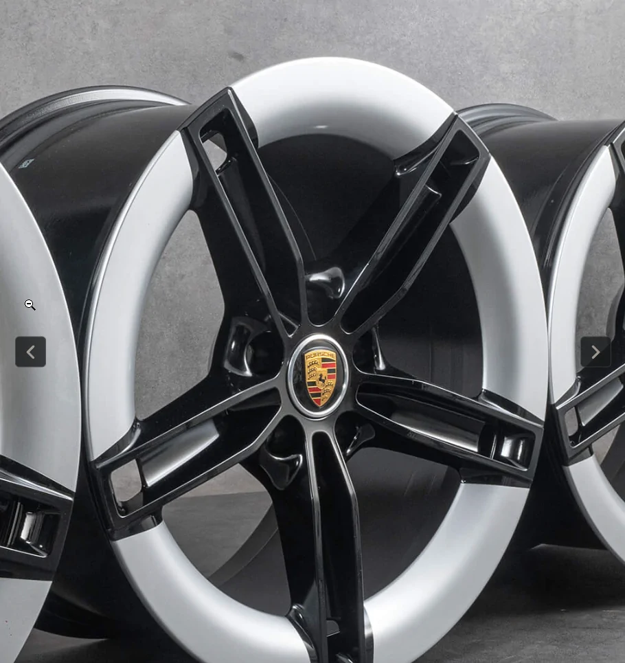

Despite the rear camera I have (very slightly) scratched the white paint on the wheels while trying to park as close as possible of the sidewalks because the car is so large bouhouuuuuuuuu lol
