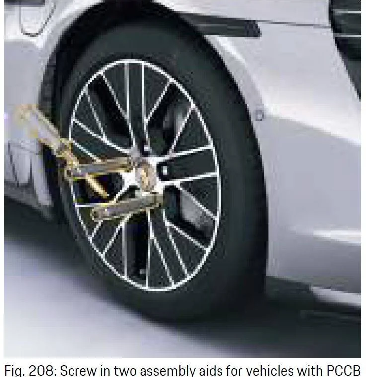

My 2014 GT3, bought new, had PCCB's. I never experienced a problem with them in 7 years; no issues with damage, noise, cold performance or excessive pedal pressure, and I loved the look of those big rotors and yellow calipers. Almost everyone who saw the car commented on the brakes. The fact that they made zero dust and reduced un-sprung weight was also a plus. And honestly, after I bought the car I never once looked back and wished I hadn't spent the extra money.
So, when I bought my Taycan 4S I went all in on the PCCB's again. I know that they aren't all that necessary on the Taycan, but then neither are options like carbon fiber accents or side skirts or any number of cosmetic things you can spend money on that offer even less performance advantage than PCCB's. Besides I just couldn't bear to go back to standard brakes, and fortunately the PCCB's still look awesome. No regrets this time either.
The replacement cost of the rotors is obviously an issue but unless you drive unpaved roads or are unlucky enough to catch a stone and score one, you will most likely be okay. One thing I would suggest is that if you get PCCB's, do acquire 2 of the "assembly aids" that Porsche recommends in the owner's manual. These are threaded aluminum rods that screw into the hub and help align and support the wheel when removing or installing it, which is when you are most likely to chip a rotor.
