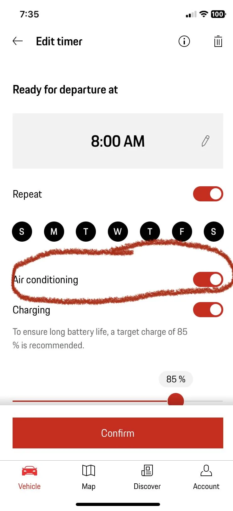

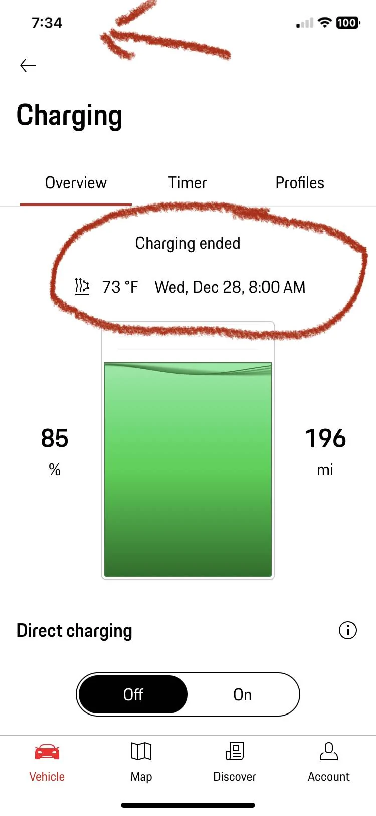

Last night I turned on the air conditioning option in the charging timer. The behavior reverted to completing one hour before scheduled time. See photos.

So what I’m thinking is that this is either a bug or the system is completing the charge early to make sure it can have the car preheated by the set time (while ensuring the desired state of charge). The message on the phone screen might be misleading and does not show the actual completed time but the desired time when all timer functions are due to complete.
