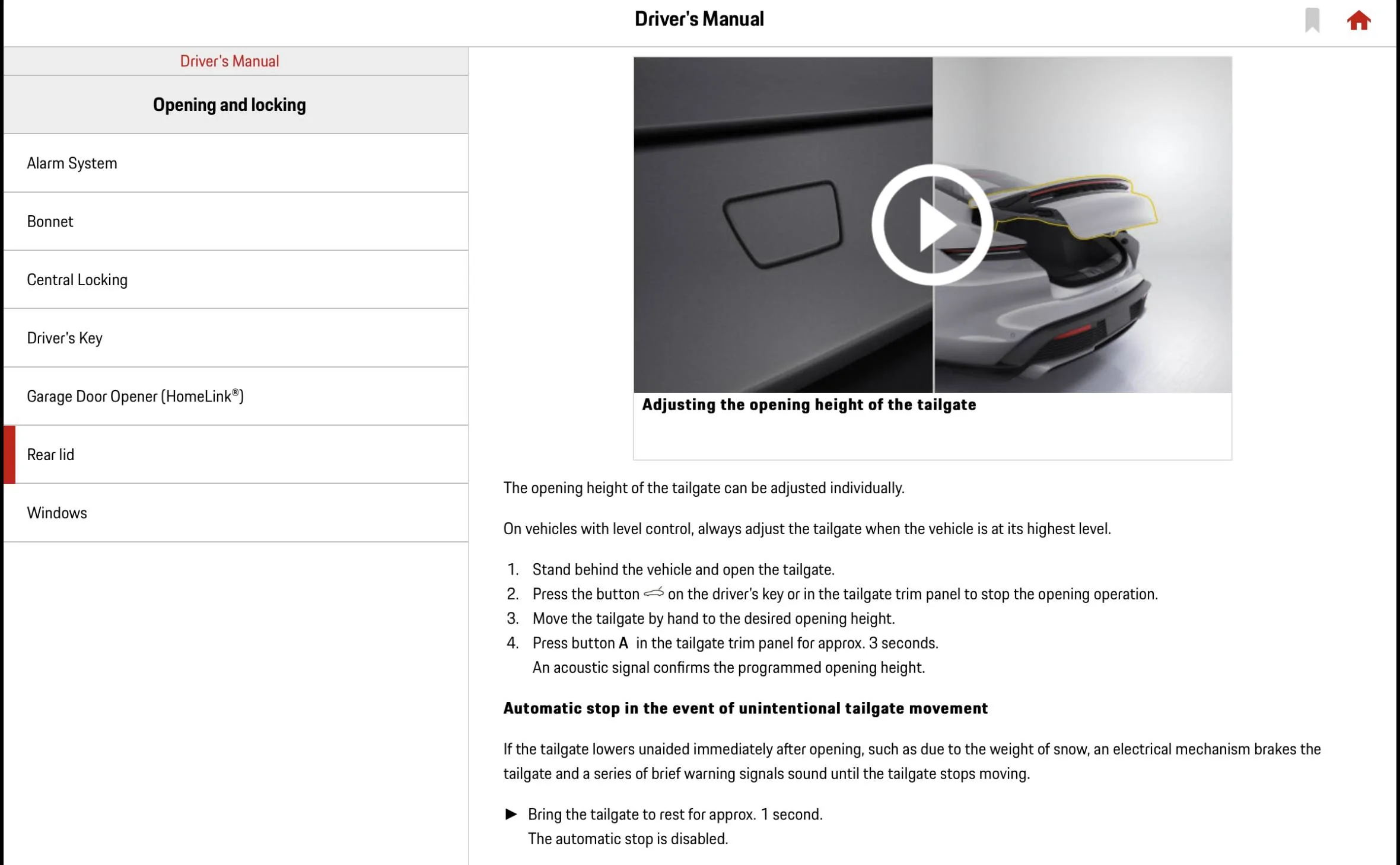

I was closing my car trunk through the remote when another person, force closed it. It went half way and then he stopped. then it wouldn’t close. So i opened it through the remote and closed it. But now everytime I open, I can’t close through the remote key. I can through the button inside but have to keep pressing 3-4 times and it stops after every bit.
what should I do :(
what should I do :(
I wonder if you have set the opening height for the rear lid by accident?
