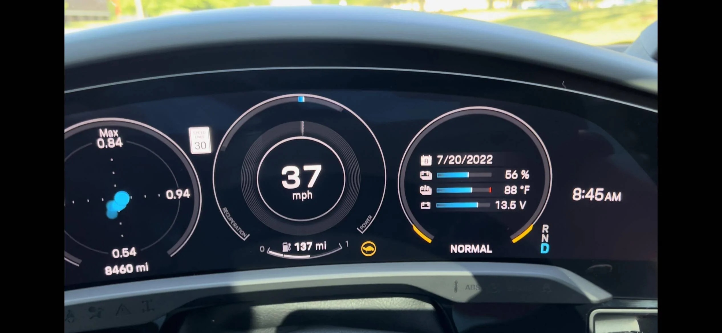

For the first time I received this turtle icon today even though my battery is at 56%. The icon was constantly popping up for 5 mins and car was jerking during this time almost like running out of gas, Anyone experienced this ?

I’ve experienced this. There’s no clear pattern but it happens once every 6-8 weeks. Turning off the car and letting it sit for a few minutes always fixes it. I’ve mentioned this to the dealership but they don’t have answers.

i had mine from day 1 after parking in the hot sun. happend a week later and had to limp home. took it to the dealer. they saw the faults with thermal management system in the logs but they were not persistent. they bled the coolant system and it hasnt come back (but has also been 15 degrees F cooler) since then.

My 2022 Taycan is a few weeks old 225 miles on it. Last night I was driving home from an event. I had 106 miles charge left. After a stop sign, upon acceleration the car the car repeatedly lurched forward, then lost power, never reaching more than 8-12 mph. The turtle symbol flashed briefly.Then it started to behave normally again. I continued to drive.
About 15 minutes later, while driving up the hill toward home the car started losing power. Turtle symbol came on repeatedly in the dash. Even though I pressed down half way on the accelerator I couldn't get it to go more than 2-5mph. I just kept losing power. With each press it went slower. I powered the car down, I waited 30 seconds and then powered back on. It started to behave normally again. I'm 💔 The dealer recommended I have it towed in today 😪

It happened to me only once when I posted this. Couple of weeks later I took it to dealer but they couldn’t figure it out. Haven’t seen turtle icon again.. so I recommend try driving close by for few minutes to see if still happens.

Its a speculation by dealer that one of temp sensor went faulty for a brief period when I had that issue. Never happened again since then and hope never will.

I bought a new 2022 Taycan RWD at the end of July. The next day while driving home from work on the freeway I got the turtle symbol and no power. Had it towed to dealership. They said it needed an update and the next day I picked it up. No problems after that. I did trade it in the end of September for a Taycan Turbo S, but it was still working perfectly then.
