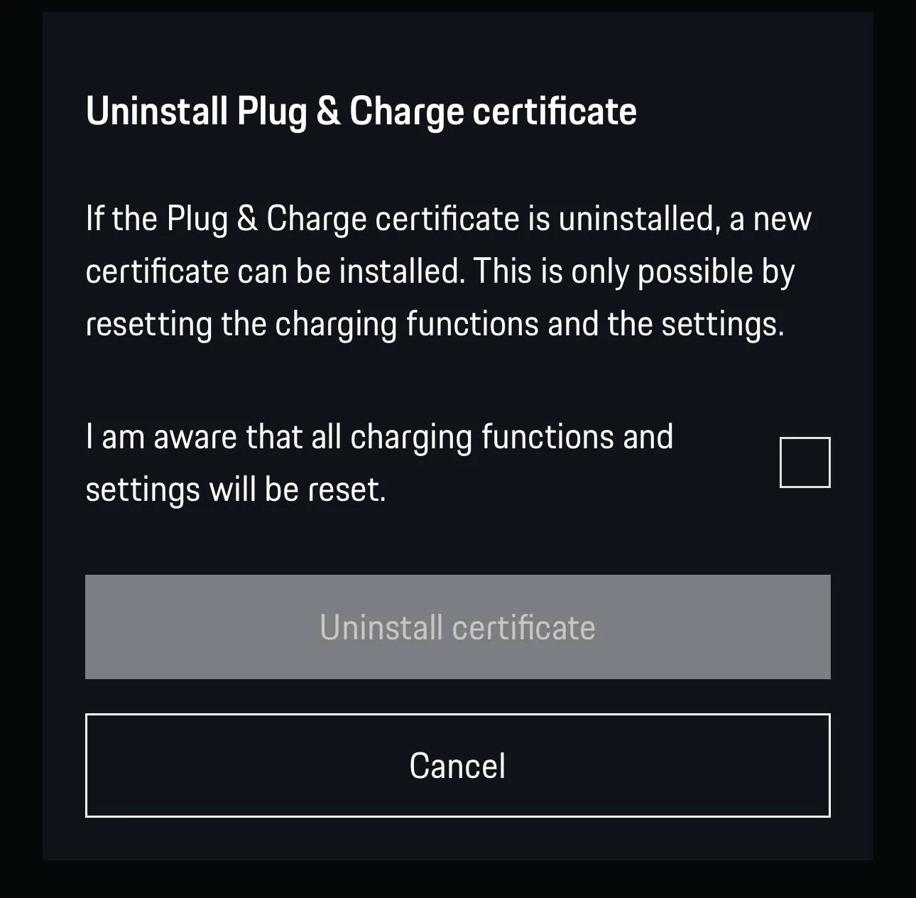

I went around in circles for a while and logged a ticket with Porsche (who in 4 years remain clueless about any Taycan query) and eventually the certificate step cleared. I deleted it and had the error reoccur on the app. Not used a P&C device in months and so didn't have a charging drama but the workaround would have been QR code or PAYG.

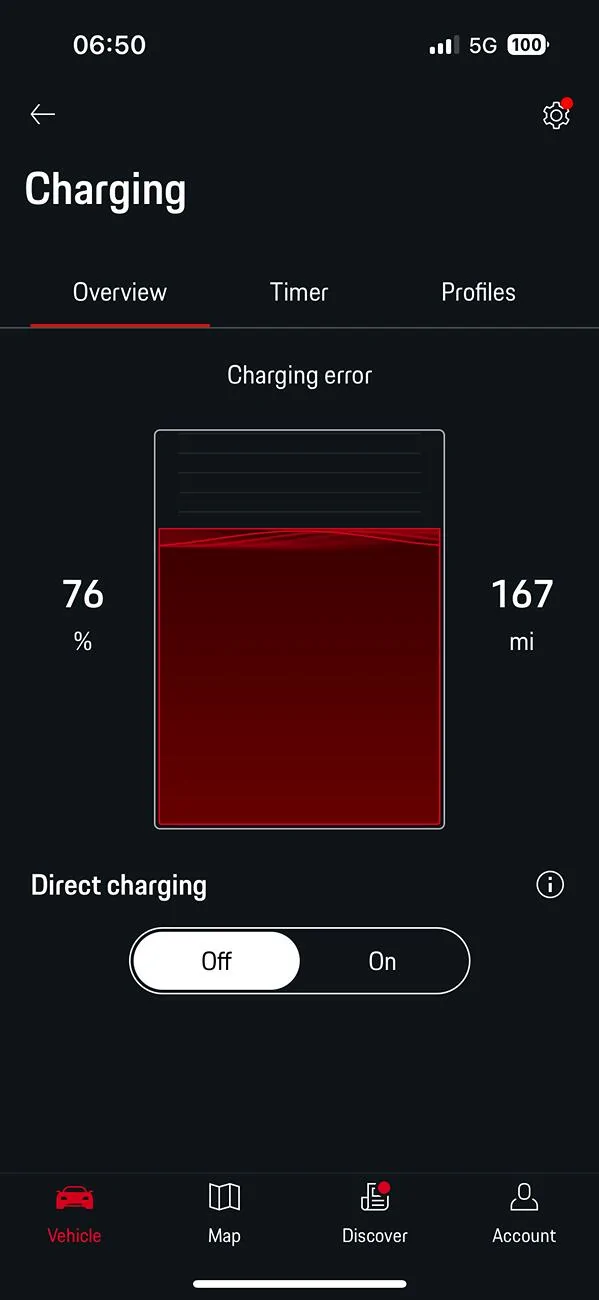

Same here. Woke up this morning and car has failed to charge. Little red dot also appeared linked to plug and charge certificate issue. Not sure if they are connected or just a coincidence, but here we go again. Tiresome Porsche, very tiresome.
Quick update. Charging issue appears to be unconnected to Plug & Charge Certificate. I went to the car and disconnected the lead as well as resetting the Zappi EVSE and was able to start charging using DC. I’ll get the car charged to where I need it today and then wait to see if the Profile works ok tomorrow morning.

Our 2020 Taycan Turbo S passed the free charging period in August (extended by Porsche NA to four years). Our car has the 22 kW AC Charger upgrade ($5,000 and two days to install, includes Plug & Charge upgrade) and Plug & Charge has worked flawlessly at Electrify America until our Connect Charging service went from free to paid. Of course, I found out with 8% charge in driving rain! Nothing I or EA did restored Plug and Charge. I used a credit card.
Called Porsche Customer Service yesterday and finally got connected to a sharp technician or engineer that knew a work-around solution. The problem is caused by the Plug & Charge contract changing when you go from free to paid charging and many Electrify America chargers cannot replace the old contract certificate with the new one from Porsche. The work around is:
  1. Reset PCM. Yes you will loose many settings but it will remember your key settings if your My Porsche account is up to date. Make sure you know how to log into your My Porsche account before you reset your PCM or you may be looking for your original PCM code from your sales person.
  2. Drive to an EA charger capable of downloading your new contract certificate - your dealer should know the ones to use in your area. In Portland, Oregon it is in Beaverton at Fred Myer, 15995 SW Walker Road.
  3. When you connect the charger to a PCM with no contract certificate, the charger will download the correct certificate in force.
  4. Electrify America and Porsche are working on a solution for all EA chargers, but none is in sight (yet). My guess is the early chargers are not capable of overwriting an existing certificate and need an empty space, or they may not be able to change anything in your vehicle.

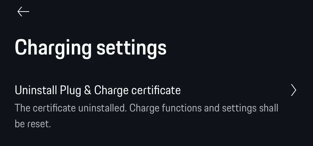

I think I noticed in early September (could have started earlier) that Plug & Charge at Ionity was no longer working.
I also noticed the app notification in the Charge settings menu about Uninstall P & C certificate.
Based on posts above, today I uninstalled the certificate.
I was surprised to see in the Charging screen my car instantly started charging at 22kW, in the middle of the day ?
Turns out my timers and profiles had just been wiped, so I quickly had to reinstate the timer which only lets the car charge up ready for 6am each morning.
No idea whether it has in fact fixed P&C, I'll have to wait until I'm next heading to an Ionity charger to validate but heads up if you do this you may wish to note down any timers or profile you have set up beforehand as you may have to recreate them.
HTH...
Edited to add - the notification has not cleared either - and it still offers me the Uninstall option in the app
