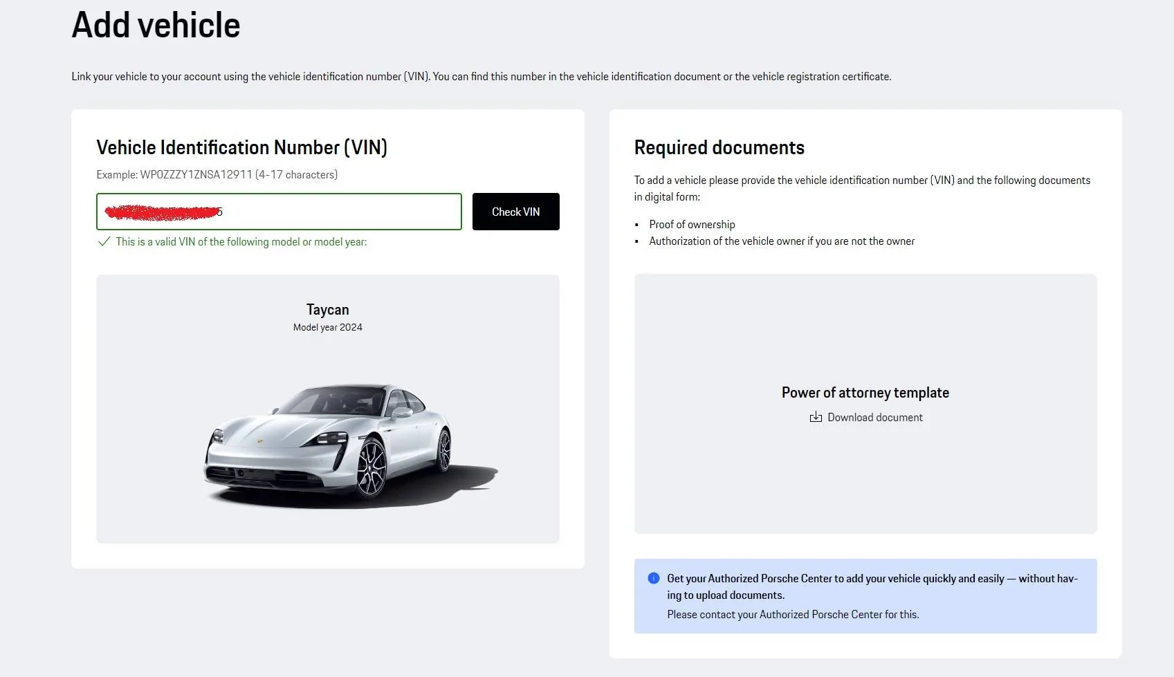

The loaner is not visible in my logged in “my Porsche app”….
The Porsche charging service is active in the PCM (it was not until I turned it on)….
I signed into the vehicle at the PCM …. But looking at it now ..... I show up as a secondary account ….
I will see if I can set myself up in the my Porsche website as a primary account but I believe you have to submit ownership documents to allow that (or the dealers has to initiate it)…. At least that is what I had to do with my speedster ….
[EDIT] .... when I try to add the car to my profile (register as primary account) ... this is the screen I get ... the dealership would need to register me I guess for Plug n Charge to work. As long as I can get the App to initiate charging (or even to pay for it) I do not care ...... but I was hoping someone else had worked through this with a brand new loaner and there was some process I missed....
