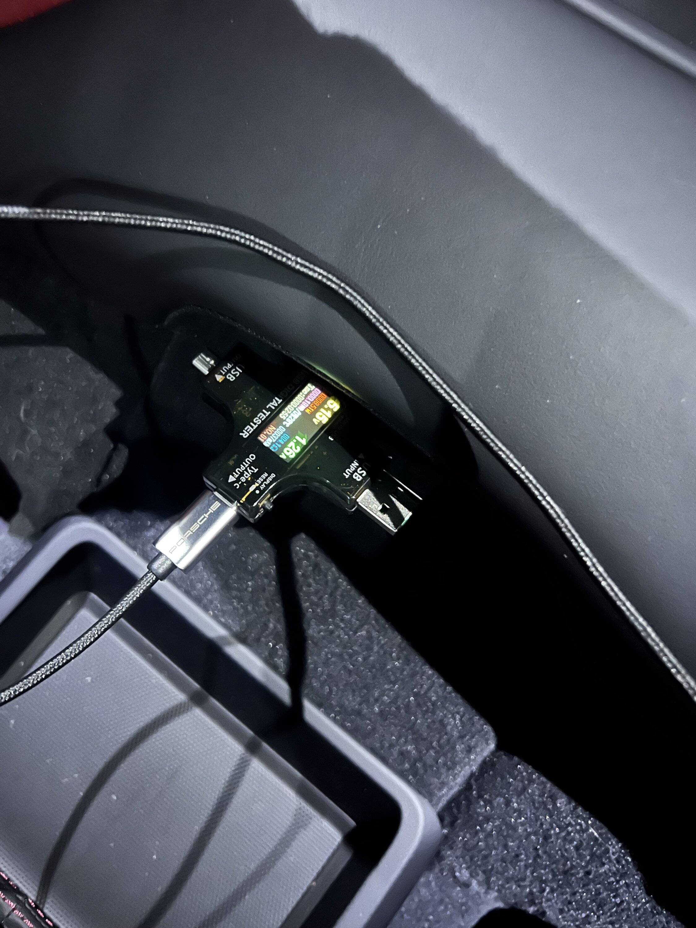

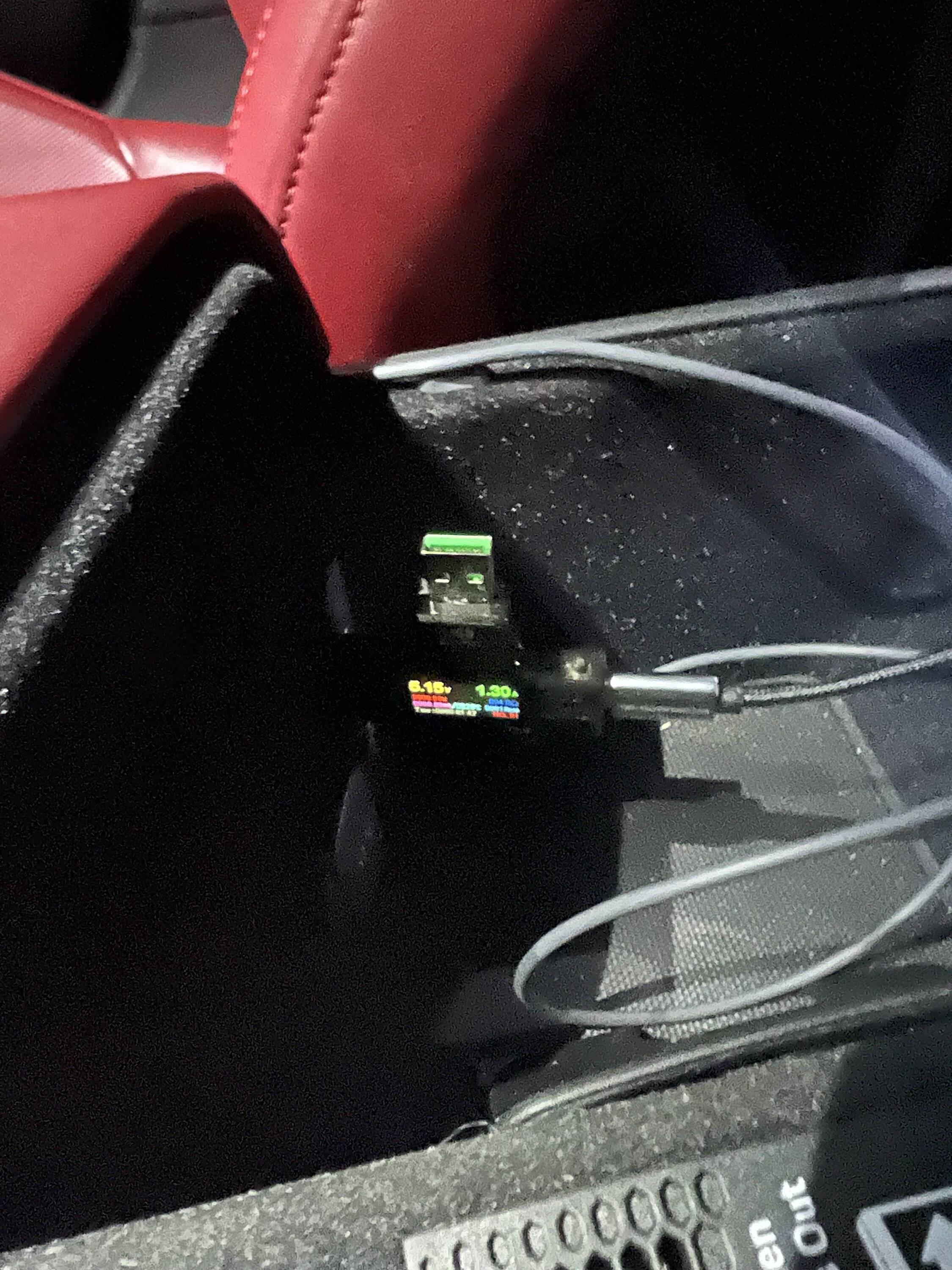

Want ahead and tested the voltage and amperage from the rear (specifically the fast ) charging USB-C plugs and compared to the USB-C slots in the cubby of the console.
Bottomline is they are essentially identical which TBH surprised me! So yes the console multi-function ports appear to offer the same level of change capability as the rear dedicated charging ports.
Voltage/amperage fluctuates for example between having the iPhone awake vs asleep and even then to some degree in either state.
It is true that the highest amperage I briefly saw was in the rear at ca 1.5 A but the front reach 1.4+A too. Voltages from front and rear are essentially the same and varied from 5.15 to 5.19 averaging about 5.17 v (so indeed not up to more recent high voltage studs but thats OK for me).
Some pics (obviously with iPhone active) - when put to sleep mode the voltage and amperages decrease in both sets of ports.
Here is an example from one of the front console usb-c ports again with iPhone attached, charging and awake:
Porsche Taycan USB-C rear charging vs Console port voltages/amps measured img_0189-jpe
And here is an example again with iPhone attached, charging and awake from the rear seat charging usb-c port:
Porsche Taycan USB-C rear charging vs Console port voltages/amps measured img_0192-jpe

So max around 7.5W ?

Have you confirmed these Taycan USB-C only support 5V (no 9V, 15V, or 20V)? That would be disappointing to hear. Any relatively recent iPhone with USB-C to Lightening cable should negotiate 9V from USB-C as long as it has a sufficiently low battery level (SOC). I was thinking they would at least support 5V and 9V.
I can confirm that the usb c ports only provides 5V, hence no power delivery.
For the iPhone 14 pro max (and Ip13 pro max) and IPad Pro (2018) I only get up to 3A. The maximum output I have seen is 15,3w. I tested with Apple usbc to lightning charge cable 1m (which has a 3A limitation on either voltage).
To supercharge either devices with up to 27w you will have to use a 12v cigarette to usb c PD adapter. I tested it and I have reached up to ~27w output charging these devices. iPhone @9v/3a and IPad Pro (2018)@15v/1,8a
(The newest M2 iPad pros will supposedly take up to ~35w @15v PD)
If anyone have different cable supporting more than 3A would be interesting to hear if you are able to draw more than 3Amps on 5V from these ports. That will conclude if these are basic Pre PD USB-c version 1 ports or if they are
BC 1.2. Definitely not power delivery.
EDIT: The Apple USBC to Lightning cable does support 5A. That concludes the rear USBC ports only delivering up to 15W. No PD.
