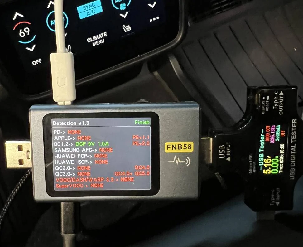

I hooked up a USB tester to the Taycan, it shows no charging protocols advertised at all, not even the old, old DCP 5V/1.5V (which is signaled by connecting D+/D- together, even my old old Blackberry USB charger had that).
EDIT: Rear ports do appear to have 5V/1.5A DCP, though there is still something weird/non standard about them that throws off some devices.

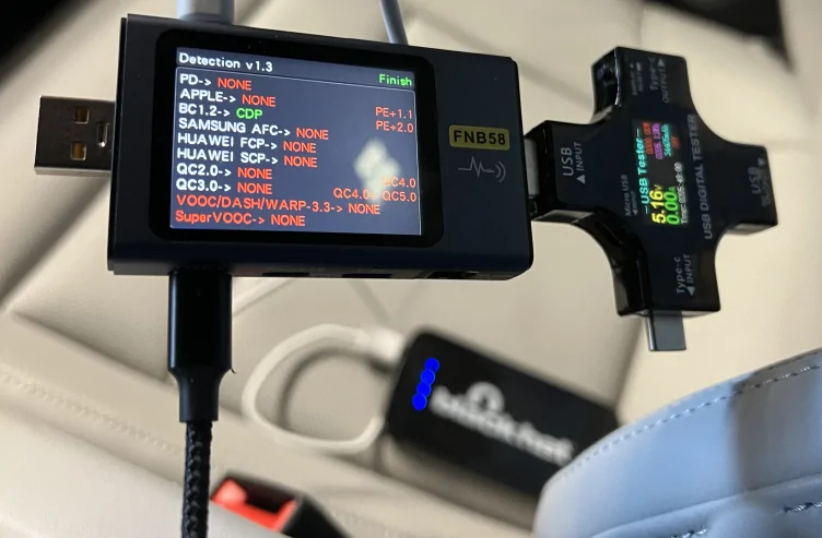

For completeness, it appears the front USB-C has CDP (which could be between 2.5W and 7.5W, need to measure with an actual device connected to see what it can negotiate as CDP doesn't advertise the max), rear has 7.5W DCP avertised. Red text means the standard is not supported.
Porsche Taycan USB-C Charging capabilities 1703117570427
Porsche Taycan USB-C Charging capabilities 1703117603513

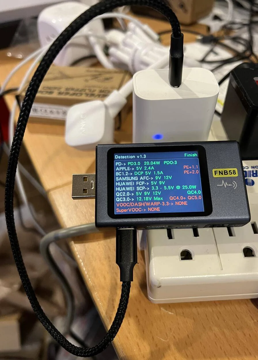

For comparison, here is what a $3 wall wart supports:
Porsche Taycan USB-C Charging capabilities 1703117816946
