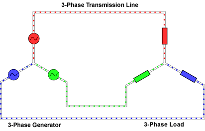

Yes, but in 3-phase loads, neutral is not used (just like in 2 phase in the USA), so the current is only between the 3 phases.
Porsche Taycan Why only 16A of 32A? 3-phase_flow
The above picture came from here:
https://en.wikipedia.org/wiki/Three-phase_electric_power
Btw, if you were to connect a balanced 3 phase loads between L and N, N would have no current (current from all 3 phases going in to the middle point in the above diagram always adds up to exactly 0). Same for USA 2 phase system, if you connect 2 identical loads, one between L1-N and the second one between L2-N, there would be no current flowing through N since the 2 phases are 180 degrees off, so their currents cancel out. This is also why when you run a 2 hot and 1 Neutral in the USA, the neutral does not have to be twice the gauge even though at first glance you might think that the Neutral could potentially return the sum of the L1 and L2 currents, but once you consider phase, you realize that Neutral will at most conduct the max of either L1 or L2. So if you L1 and L2 are sized for 50A each, then N can also be sized for 50A, not 100A as it would be in L1 and L2 were in phase (0 degrees apart).
