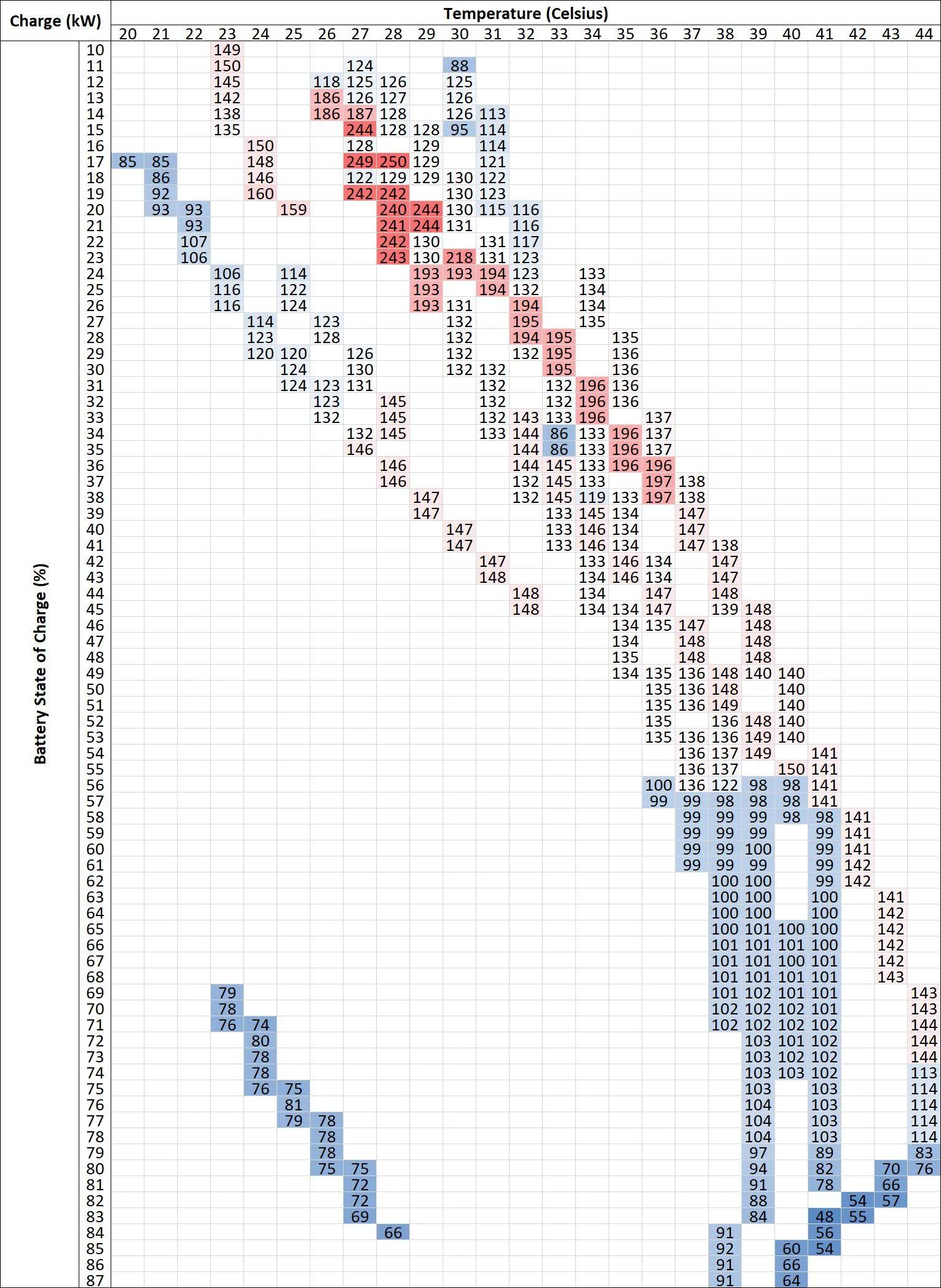

Mostly relevant for the 150kW chargers, there is a very sharp drop in the Taycan charging rate around 55% if you're not at the target temperature. If you're 1 degree too low, you get dropped to 100kW. It's annoying because the car will charge just fine at 150kW for another 20-30% with just that tiny extra degree. The cutoff seems to be 42°C. See the big table at the end around the 55%/40C area. I've seen this over and over again, so it's definitely the car, not the charger. @daveo4EV had a similar thing happen in this thread.

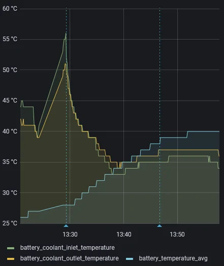

Below the first blue marker is the start of the charge, and the second when the charging rate dips to <100kW. When the green line (temp of coolant entering battery) is higher than the the yellow (coolant exiting battery) one, the car is heating the battery, and they they flip it's cooling it. Here it seems to cool the battery too aggressively for optimal charging time (?).

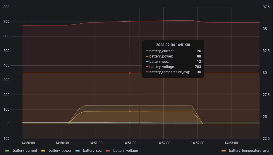

On the chart to the right, yellow is power to the heater and green to the compressor. You can see the heater turning off as soon as the car is plugged in.

Then finally, the actual table with the logged values. This is on the "P" update, with a PB+ car, across ~10 charging sessions.

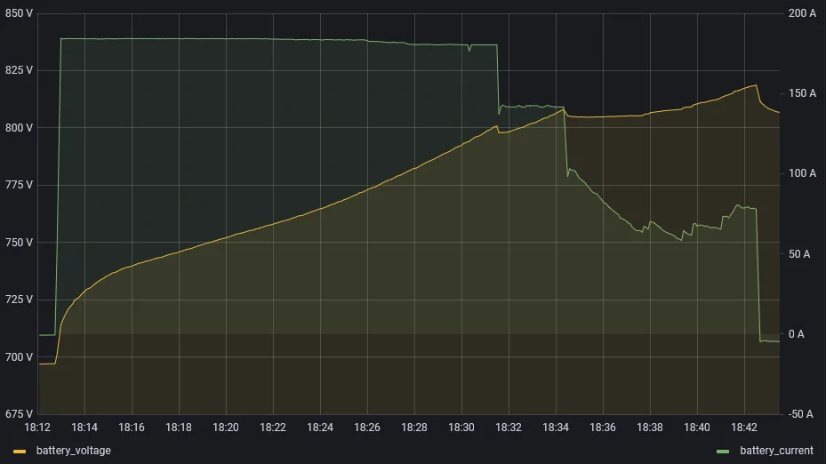

- The power limit is current (amperes). If a charger can only output 100A, at 700V that's 700*100 = 70kW; at 800V 80kW. So it's normal to see the rate of charge increase as the battery fills up -- when the charger is the limiting factor.
