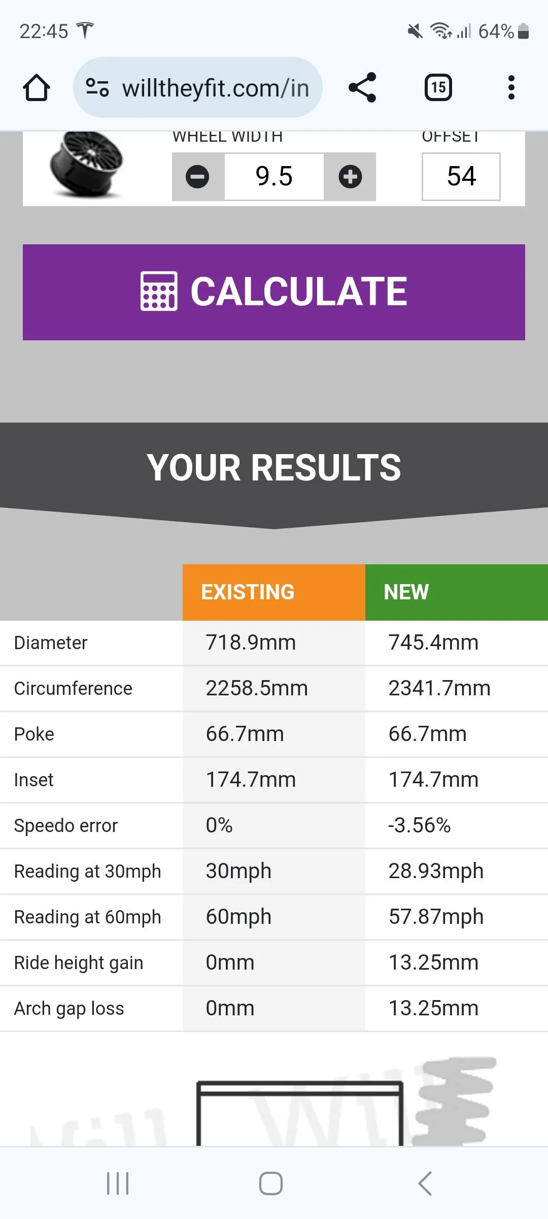

Hi there.
OEM 21 inch set up is for summer tires. No NF0 rated winter set up yet in 21 inch. Nonetheless, driving Michelin 21 inch winter set myself.
I wouldn't recommend that tire width as you have mentioned above...as your wheel circumference will be "way off", -3.5% as I see.
Have your data put in on websites like willtheyfit.com (see screenshot) and you will see that speedo error is quite significant (and therefore possibly associated system/sensor errors).
Stick to 265 front and 305 rear.. Pirelli Sottozero 3? Michelin pilot alpin 5?
Porsche Taycan Winter tire fitment - 21" inch Screenshot_20240106_224509_Chrome

Thanks very much for your quick response. I suppose I will look into getting a 19 inch set.
