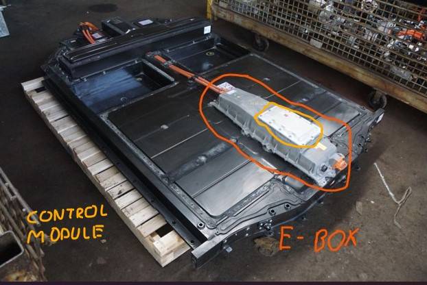

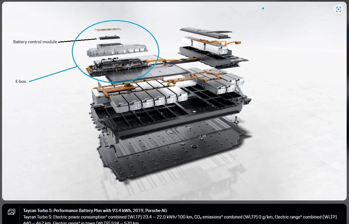

What is an e box and also
When I was at dealer couple months ago, I asked Taycan service tech what was the E-box. The shop had a HV battery removed from a Taycan. He pointed out that E-box was the box projecting up on top of the HV battery. My understanding is that E-box is heart of the HV battery management system. See below for photo I found online and marked up.
Although some in here have reported their Taycans had the E-box replaced, a recent TSB/recall from Porsche has indicated that the E-box is integral to the HV battery. E-box and battery are single unit which should be replaced as a unit.
Porsche Taycan Won't Start ebox and control module photo
Edited: Added another photo:
Porsche Taycan Won't Start Taycan HV battery exploded
Edited: added link to video showing internals of E-box and repair (starts at 6:10 minutes):
