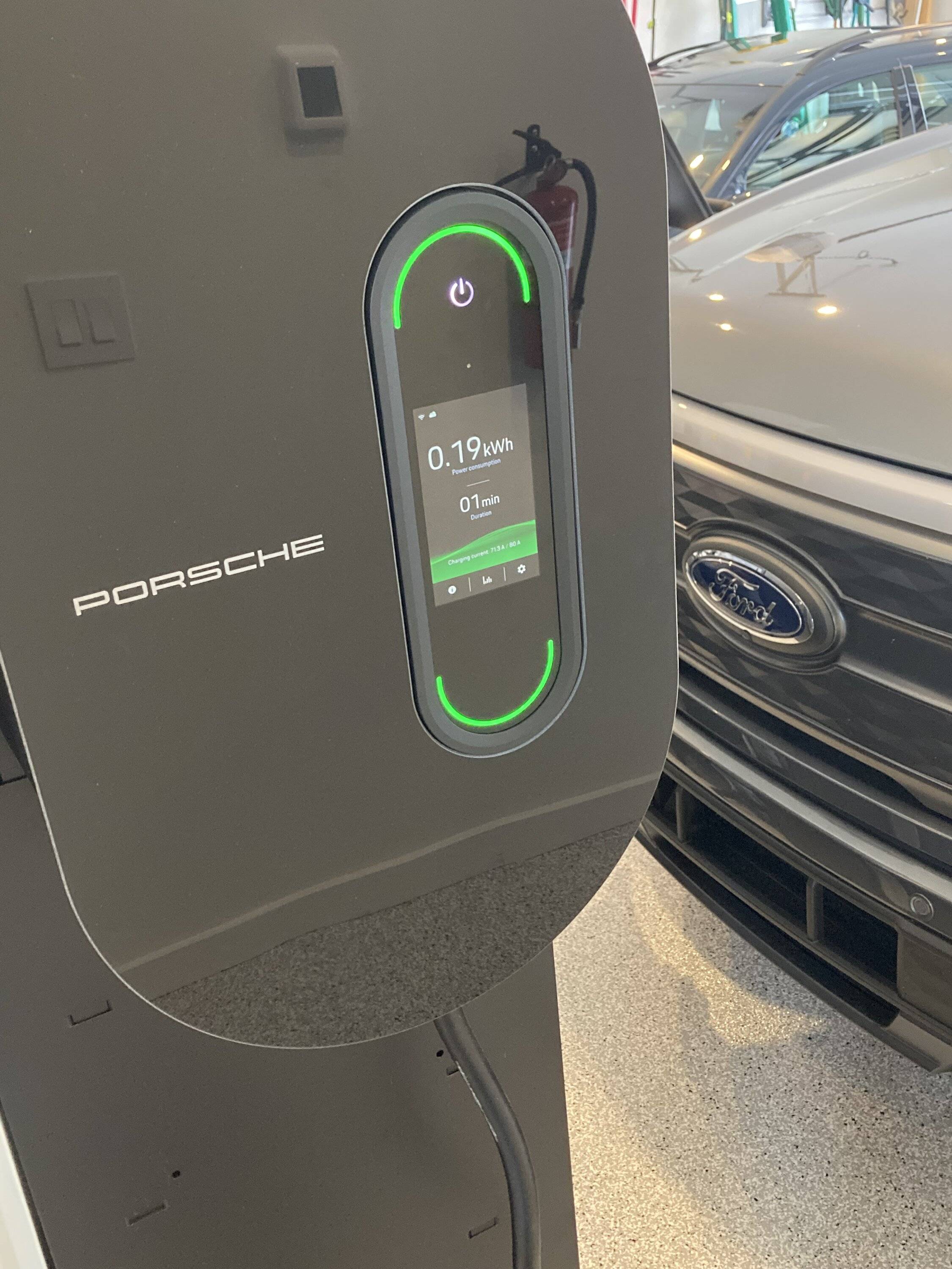

Guess I’m in the minority but I love my PWCC. I just plugged the Taycan in at 34% and it will be at 85% in less than three hours At 18kwh. Plus my F150 lightning loves it.
I think most of the dislike here is against the PMC+ and PMCC. PWCC is a decent option, especially if you can hook it up to a 100A circuit to take advantage of the 19.2KW charging rate. The only drawback of the PWCC are:
  1. does not load share with other PWCC's
  2. some reports it was not playing well with non-Porsche cars. It seems for you it works for all the cars you want to use it with
Out of curiosity, does your PWCC have an app/web access which reports back the charging history and current SoC of the Taycan?

If it does I’m not aware of it! I use Porsche connect. When I charge the lightning the Ford app calls the PWCC “unknown AC charger” and Porsche connect doesn’t acknowledge or monitor the Ford charging. I have an extended range Lariat lightning which includes a free Ford Pro 80 amp evse which is supposed to ship directly from Sunrun a few days after Lightning purchase. I’ve had my lightning for a month and still no charger. Not a big deal as we have the PWCC but there are a lot of really pissed of lightning owners who are still waiting on chargers. i will install the ford charger outside when/if it arrives as the wife doesn’t like her taycan outside while my truck is hooked to “her charger” In the garage.
