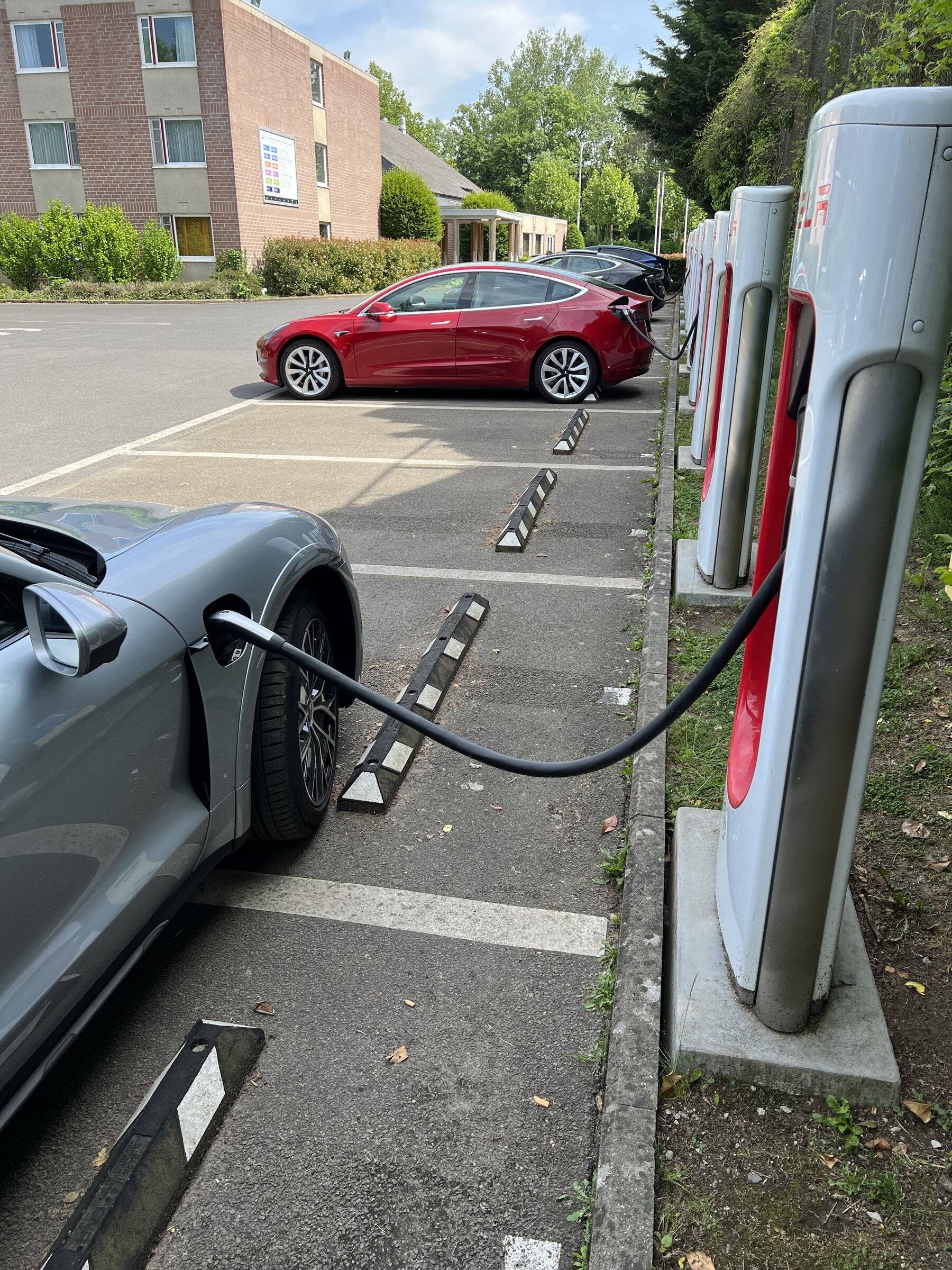

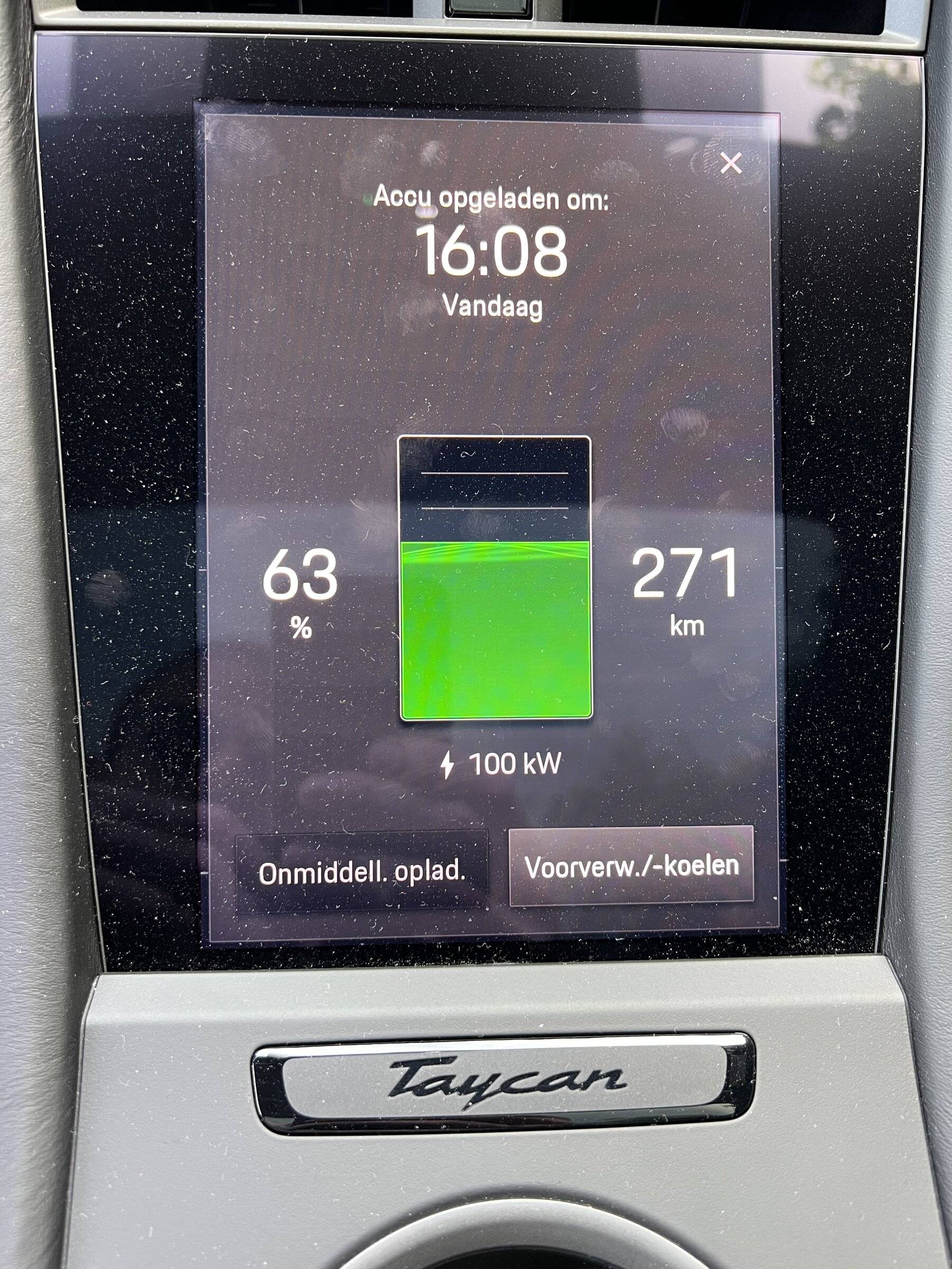

Tried a 150 kw Tesla charger this weekend and I had 100 kw charge speed. With 31 degrees battery temperature and 60 SoC. Should be even higher with a lower SoC.
I had to put my car in an (not allowed) alternative position. For Taycan owners only the v3 chargers with parallel position will work well because of the short cable. With the parallel position the nose of the car can be parked between the chargers.
Ps I checked with the Teslas charging if they would be bothered if I did this. And still 8 positions free for charging.
