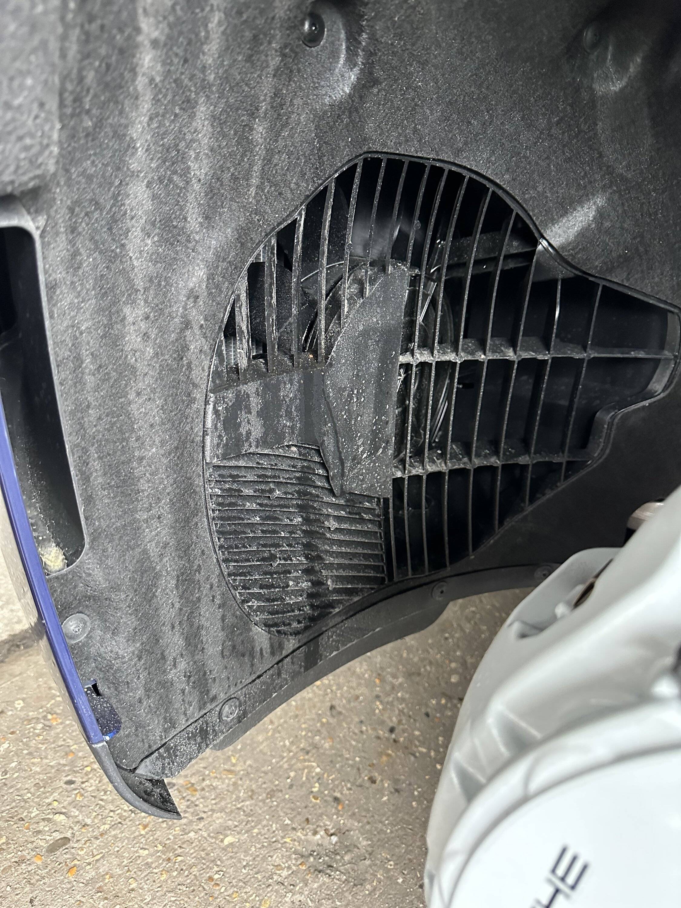

Symptom: Customers complain about droning or humming noise from the front end, even during the charging process.
Cause: This may be caused by foreign matter or dirt in the area of the electric fan and/or between the fan rotor and fan frame. Frequent driving on unpaved roads or roads with a gravel or grit surface or on sanded roads (winter) exacerbates the problem.
Remedial Action:
A new component status of the electric fan (fan with frame and fan motor cap) as well as the air guides
and lower parts of the wheel housing liners is available immediately.
The new design has additional and larger foreign matter elimination openings on the underside as well as
a protective cap to prevent dirt and stones from entering the fan motor.
https://static.nhtsa.gov/odi/tsbs/2023/MC-10237401-0001.pdf
Cheers. I wondered about this when I had the left front tyre off in January at my local tyre place and had a peak inside the wheel well.
Bit hard to tell what they specifically updated on the MY23 cars from a cursory look...
Porsche Taycan TSB: Noise - Droning / Humming from Vehicle Front End -(redesigned fans, air guides, wheel liners)- May 10, 2023 IMG_0615
