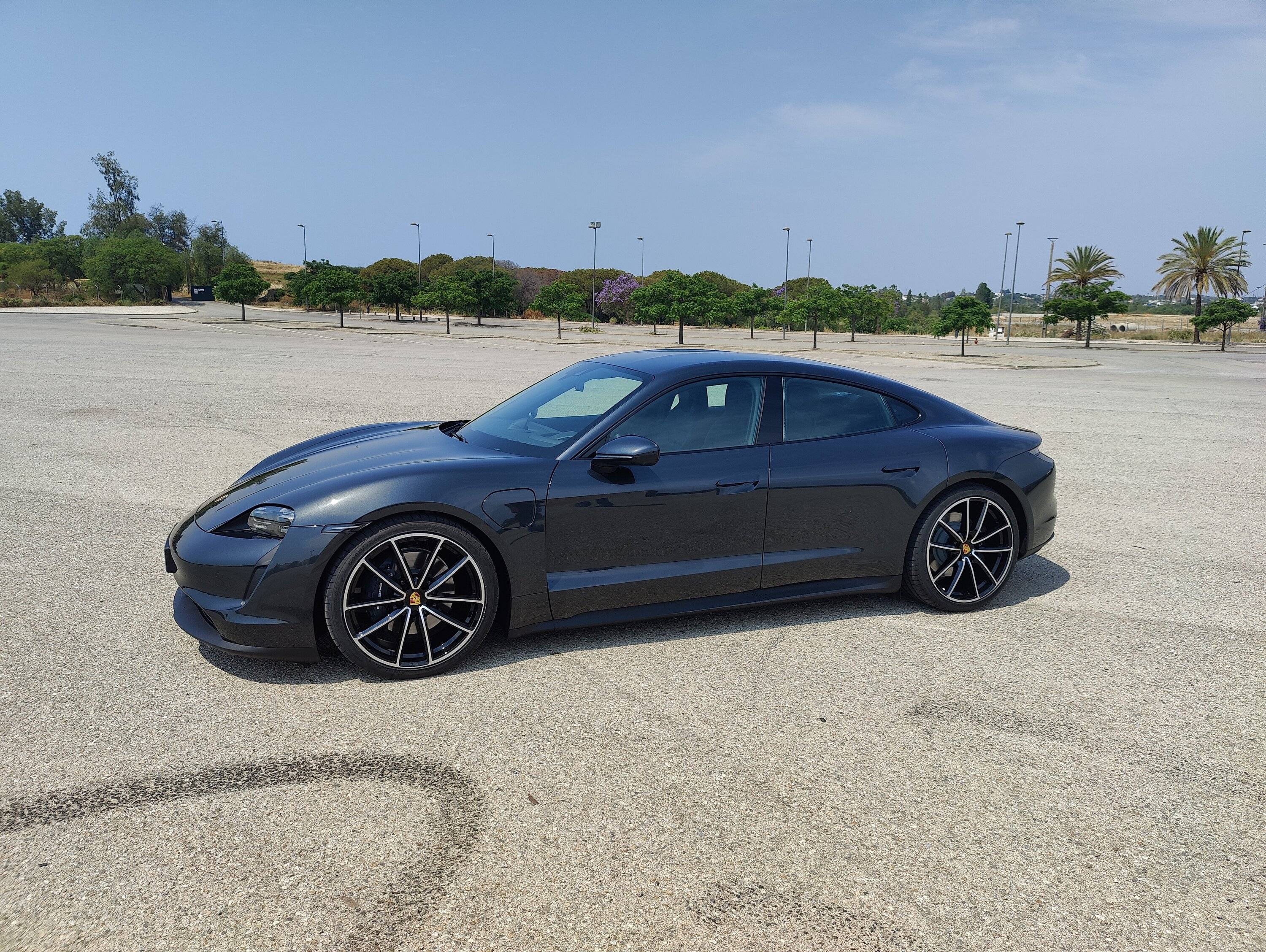

Nice write up and lovely car! Are those 22” btw?

What wheels are these?
GMP Italia Titan 21''

They are 21 ?
