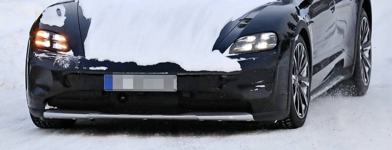

I drive into the Canadian ski mountains weekly with my Taycan 4S CT and point out the following for those doing winter driving research:
Pro's
  • Traction is excellent, better than my Macan. Also observed on my Tesla, the Taycan power deliver seems much smarter that mechanical differentials.
    • You can literally launch control on snowy roads and the car will accelerate straight and smoothly at its traction limit.
  • Gravel Mode apparently provides more "wheel lock" so all four wheels deliver more power rather than the one(s) with most traction. Good for snowy hills, getting unstuck etc.
  • Preheating is excellent and responsive.
Cons:
  • Unlike an ICE car, it never heats up on the hood, undercarriage etc. This can lead to snow build up in wheels, on hood and other cracks and crevices since there is no melting while driving. After three days of wet snow during day and freezing at night there was considerable accumulation.
  • Snow or ice always builds up in the gap where wiper blades rest which can become a problem after a few days.
  • The rear window fairing and rear hatch have very tight tolerances leading to binding if ice accumulates here. Need to be careful not to open truck until this area is clear. It seems that it's possible to cause damage.
  • Charge port opens sideways so it doesn't create a "roof" for the port. Ice and snow can accumulate in the port area over night.
  • Preheat doesn't enable front and rear defrost.
Hope that helps.

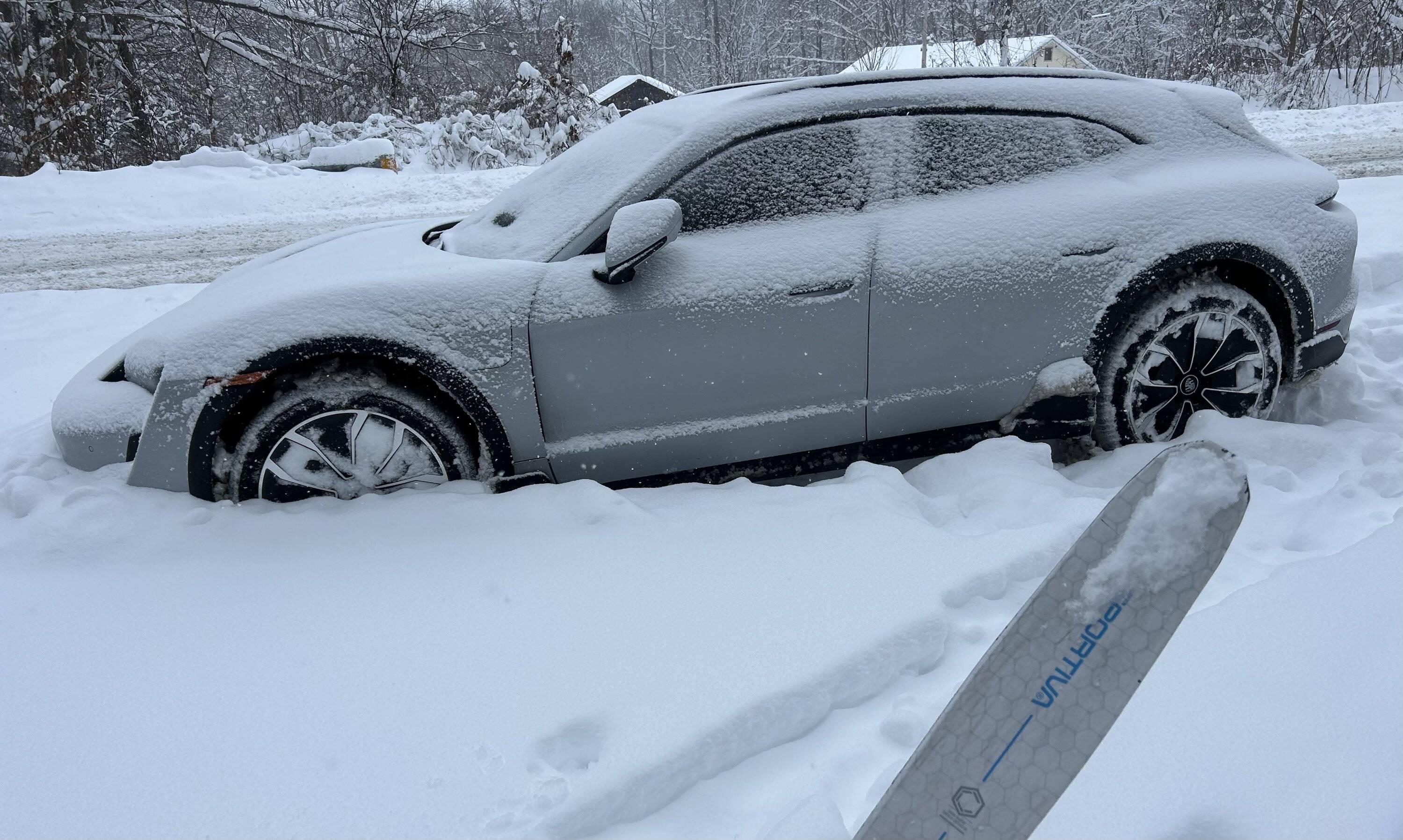

"Unlike an ICE car, it never heats up on the hood, undercarriage etc. This can lead to snow build up in wheels, on hood and other cracks and crevices since there is no melting while driving. After three days of wet snow during day and freezing at night there was considerable accumulation."
I was confused at first on Sunday when I was driving home in a snowstorm and my hood stayed all snowy ... then I remembered, oh yeah, no engine up there!
Otherwise, no complaints.
Here's a pic of my CT in the snow when we returned from backcountry skiing to the trailhead.
The entirely unplowed trailhead parking lot, with about a foot of snow.
You can see how the front end has been acting like a plow as I pulled into the lot, in Gravel Mode with the Lift height setting.
Super easy though blasting out (with 20" Michelin CrossClimate2 tires).
TikTok here from my social media consultant (i.e., our teenage daughter), with skiing so good that a friend came all the way from Richmond Virginia!
(Actually, he came all that way for the ski mountaineering race I had organized the prior day, but he *stayed* for the powder!)

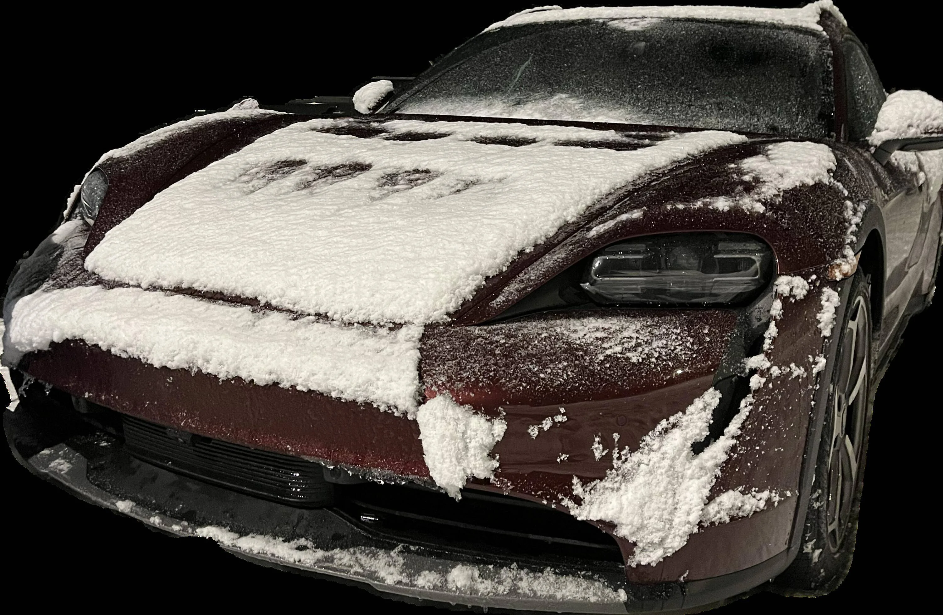

“Unlike an ICE car, it never heats up on the hood, undercarriage etc. “
Pedantically, this is not quite/fully correct. The heater and passages that direct warm air into the cabin are under the hood, behind the frunk. Snow accumulation on the hood starts melting at that location (roughly between the front suspension top mounts). Here is an older pic, to exemplify.
Porsche Taycan Extreme Winter Driving pros and cons with Taycan 1704848012768
No disagreement on other areas - front air dam, side vents etc.
By contrast, the headlights on the Macan are much more predisposed to icing and becoming obscured by accumulating snow; the projector is far behind the lens, and whatever heat it produces is insufficient to melt the ice.
