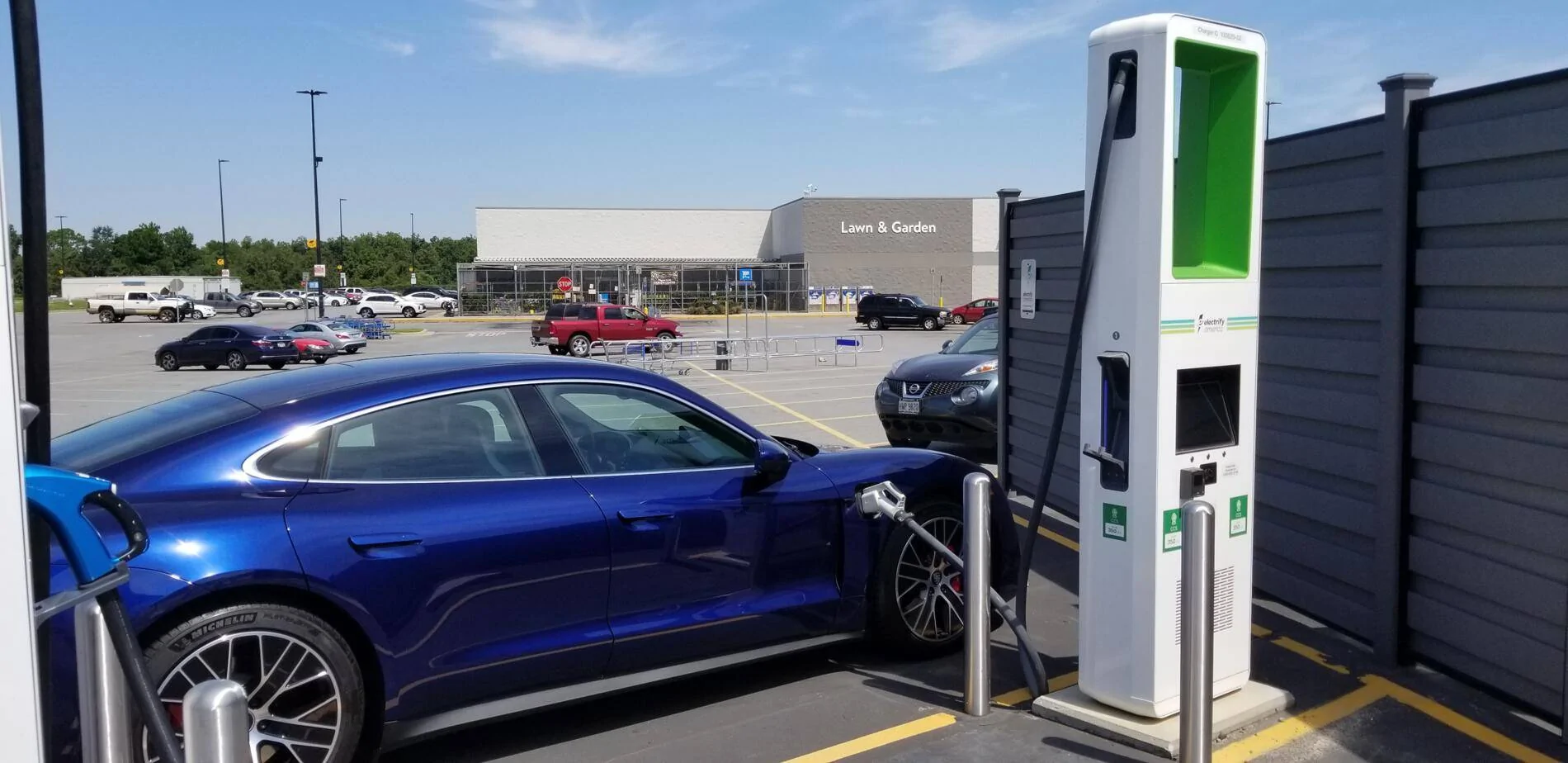

Cordele, GA co-located at a Walmart

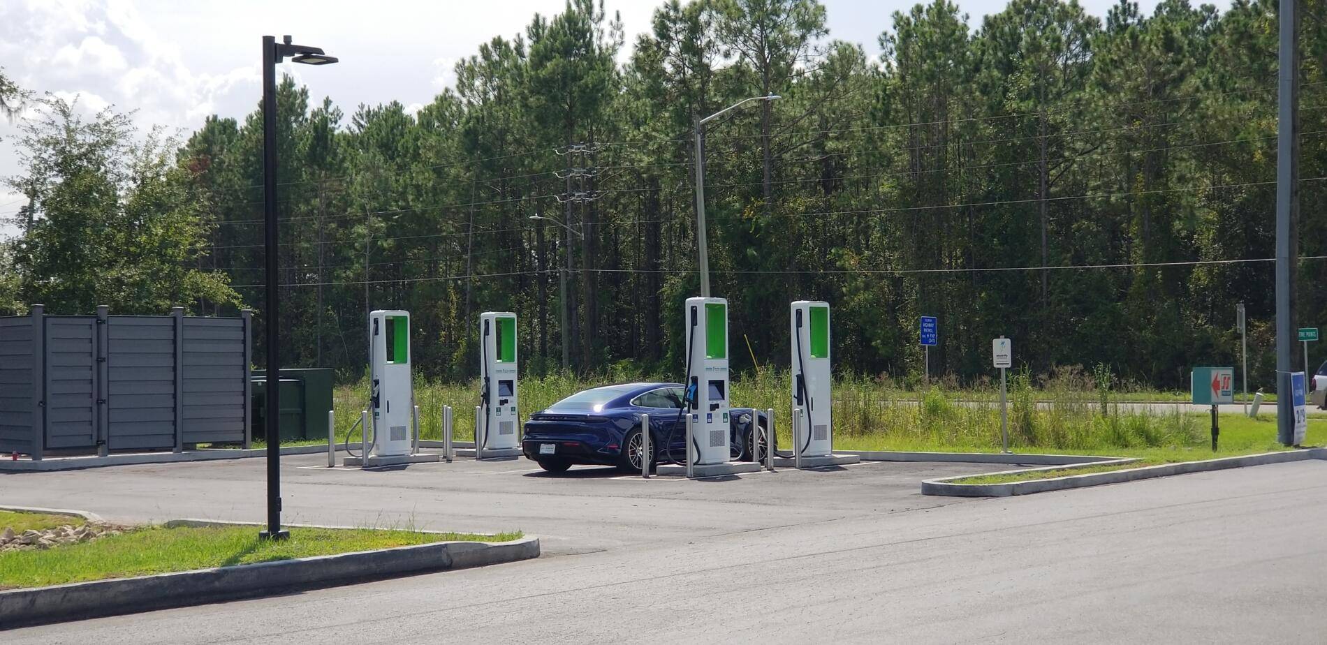

Lake City, FL - at an S&S gas station and convenience store
