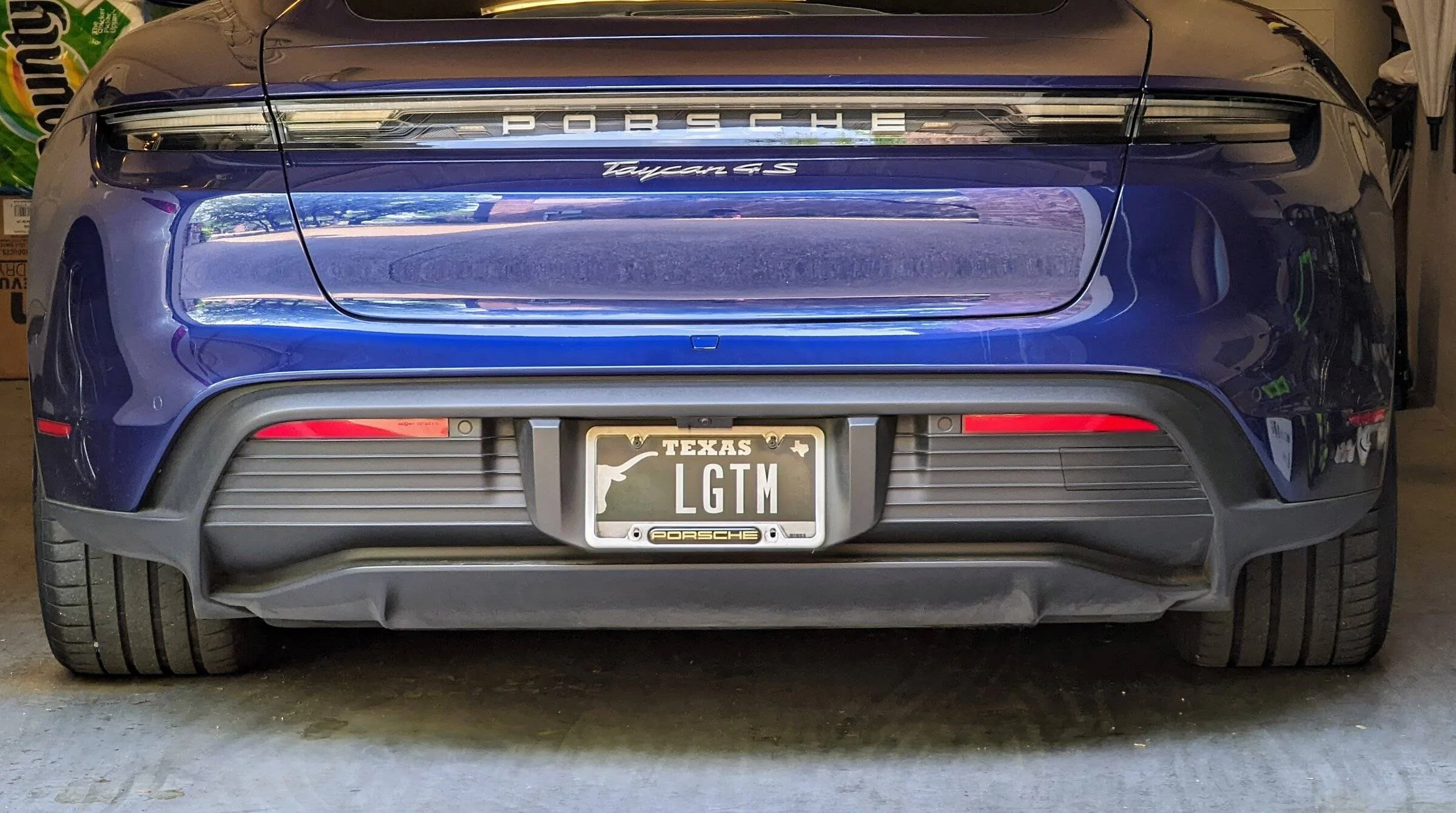

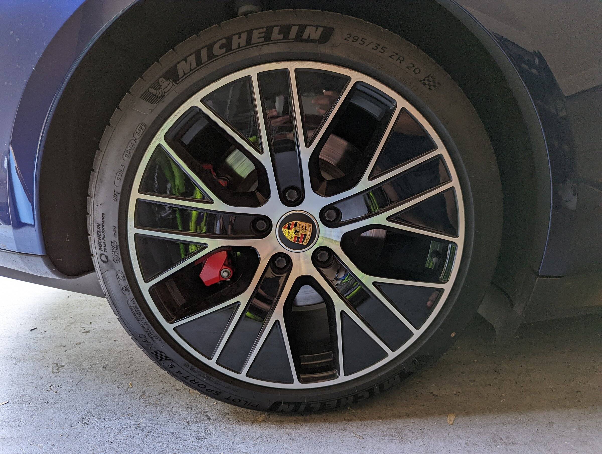

I swapped out the factory-installed Michelin Pilot Spot 4 summer tires for MPS4S in 255/40ZR-20 (F) and slightly-wider than stock rears 295/35ZR-20. They're much stickier and better suited for track driving than the factory tires.
Slightly off topic but would be interested to see how these tires look on your car with respect to sidewall/size. Have already ordered aftermarket 20s for my incoming Taycan and debating whether to reuse the factory 20 MPS4 or get aftermarket AS/4s in the 255/295 size
The 295s fit nicely. Taycan GTS comes standard with:
  • Front: 9.0 J × 20 ET 54 wheels with 255/40 R20 tires
  • Rear: 11.0 J × 20 ET 60 wheels with 295/35 R20 tires
Which is the same width wheels as the 20" options on other Taycans. I've attached a photo of the 295 width MPS4S tire on my 20" Taycan Turbo Aero Wheel. It looks nearly identical to the OE Michelin Pilot Sport 4.
I have started noticing that my speedometer is a few MPH optimistic, but I can't tell if it's always been this way or because of the 285-->295 fitment. For example, I'll be going an indicated 50 MPH past a "Your Speed" radar sign, and the sign will say 47. It was most noticeable on track when I thought I hit 152 MPH on the back straight at COTA, but the lap video shows a GPS-measured 147 MPH.

Thank you! Re: the 285->295 fitment, the overall tire size did decrease by ~3% given aspect ratio reduction so that may be the reason why. I've heard in the Taycan you can change wheel settings in the PCM for different wheel sizes. The OEM 21" fitment in 305/30/21 is a lot closer in overall tire diameter to the 295/35/20 so perhaps may be something worth trying changing to that instead
