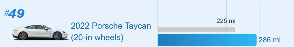

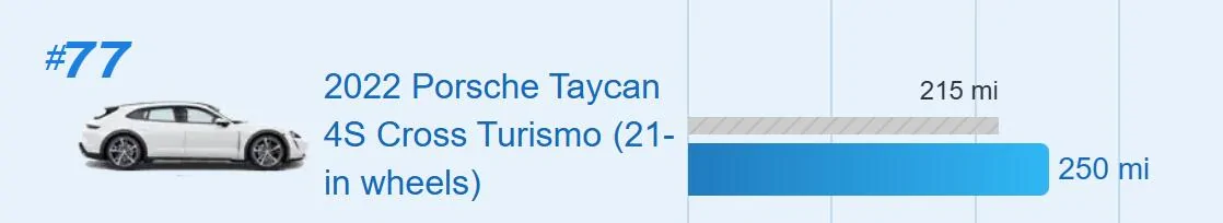

EPA numbers are bogus and unrealistic for Taycans. There are plenty of real world tests published that exceed EPA numbers by a lot. See Edmunds: https://www.edmunds.com/car-news/electric-car-range-and-consumption-epa-vs-edmunds.html
EPA is Grey
Edmunds Test is Blue

That is why Porsche did the independent test to show more realistic ranges for Gen 1 and had it on the website along the EPA numbers. However, I cannot locate that information on the website any more since only Gen 2 information is shown.
