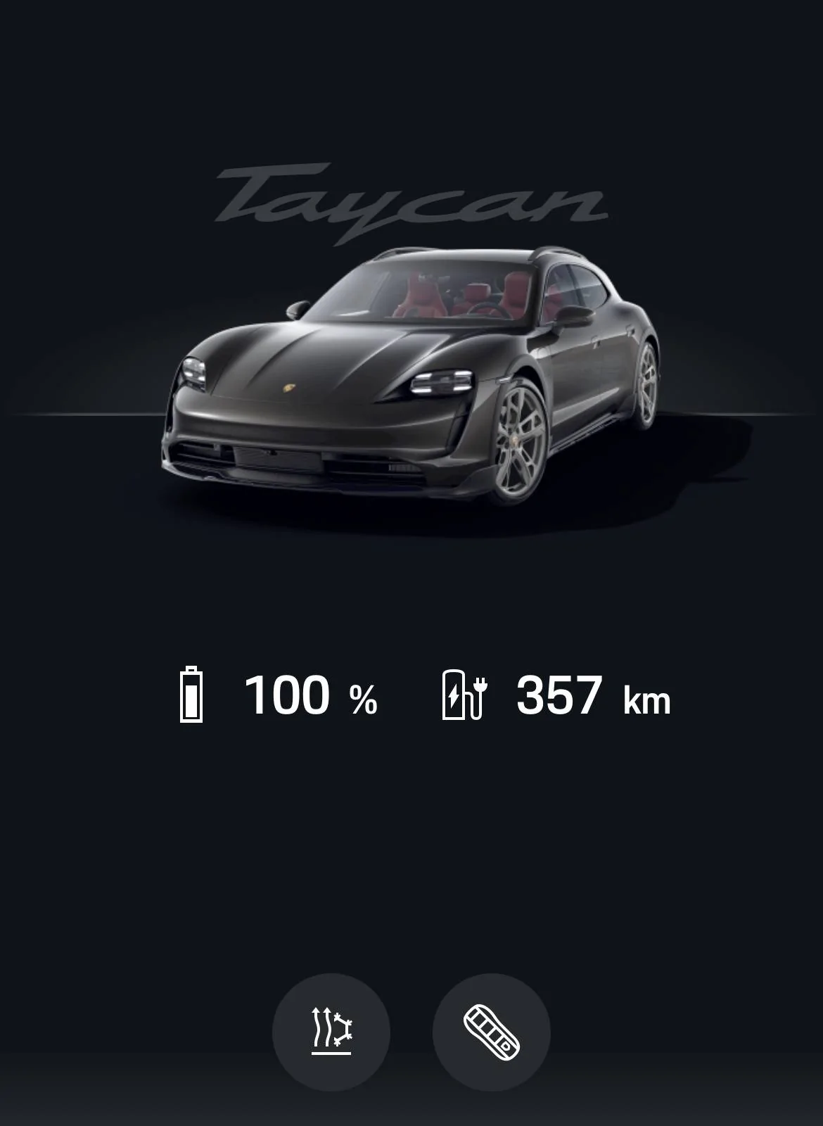

In my experience the guess-o-meter is actually a lot more accurate after the big update.
I also lost about 50km of range after the update, but now it is consistent with the consumption, before it was too optimistic. This winter up until now I get about 23 kWh/100km and the range indicated is 360km, which is correct. In summer I get more or less 19,5 kWh/100km so the range will probably increase to about 420km.
