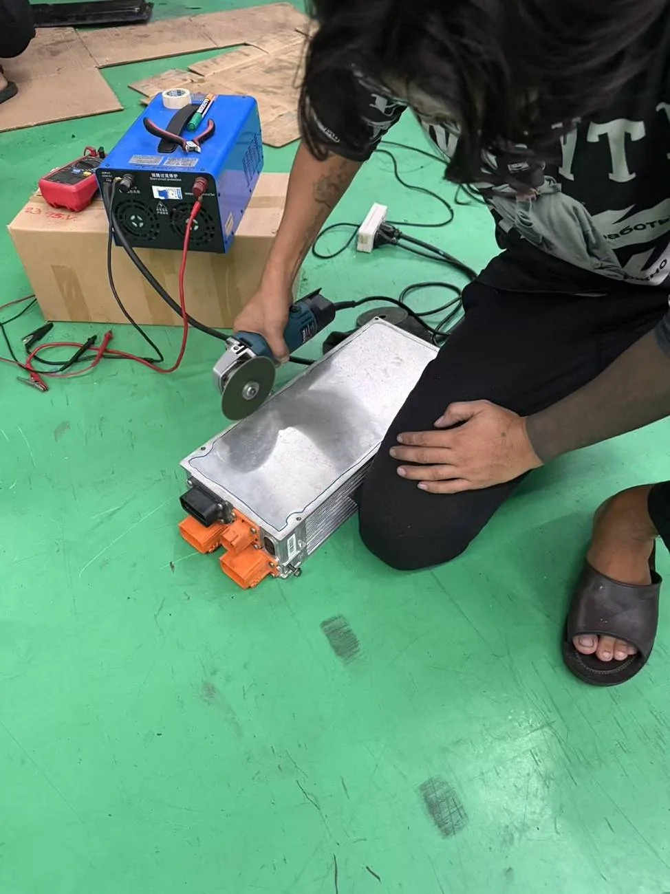

Porsche failed to root cause the issue. If someone in a 3rd party garage can do it, why couldn't the mighty Porsche have figured out which part is failing and why.
I don’t quite picture Porsche taking an angle grinder and cutting opened failed OBCs as we do
Porsche Taycan 22KW OBC FAILURE INSIGHT & POSSIBLE SOLUTION 90ffead473089e0f5c2fd9117553bf25
Porsche’s position is that the OBC is one piece and unserviceable. They’re not gonna change this opinion.
instead they ditched the part when they got tired of it
