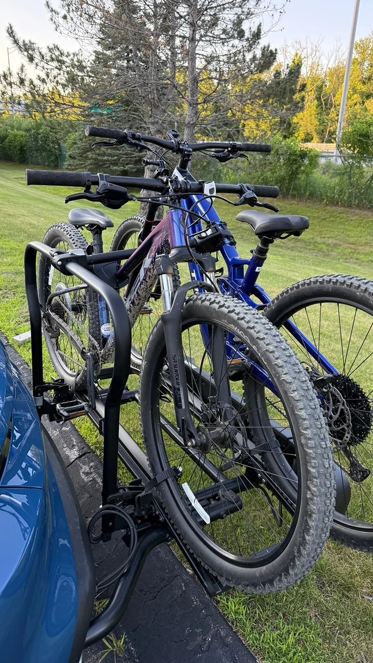

Stan here's a picture I found on the side closer to the trunk of the car with the bike mounted.
Porsche Taycan Taycan Cross Turismo Bicycle Rack Install - DIY Video IMG_0257
Porsche Taycan Taycan Cross Turismo Bicycle Rack Install - DIY Video IMG_0135

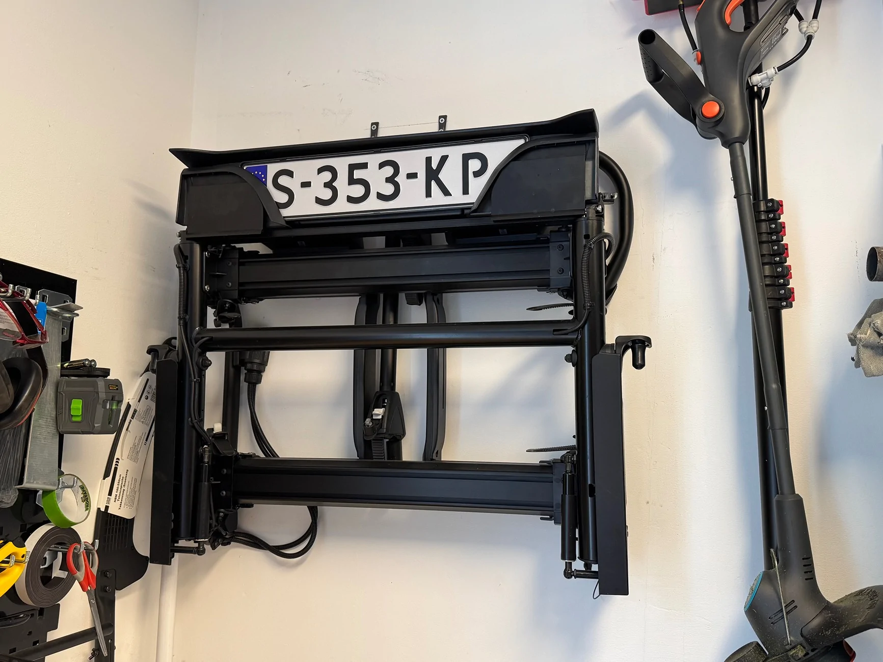

Anser for your second question; it is not that heavy. I have wall mounted it. I can lift it by myself.
Porsche Taycan Taycan Cross Turismo Bicycle Rack Install - DIY Video IMG_0429

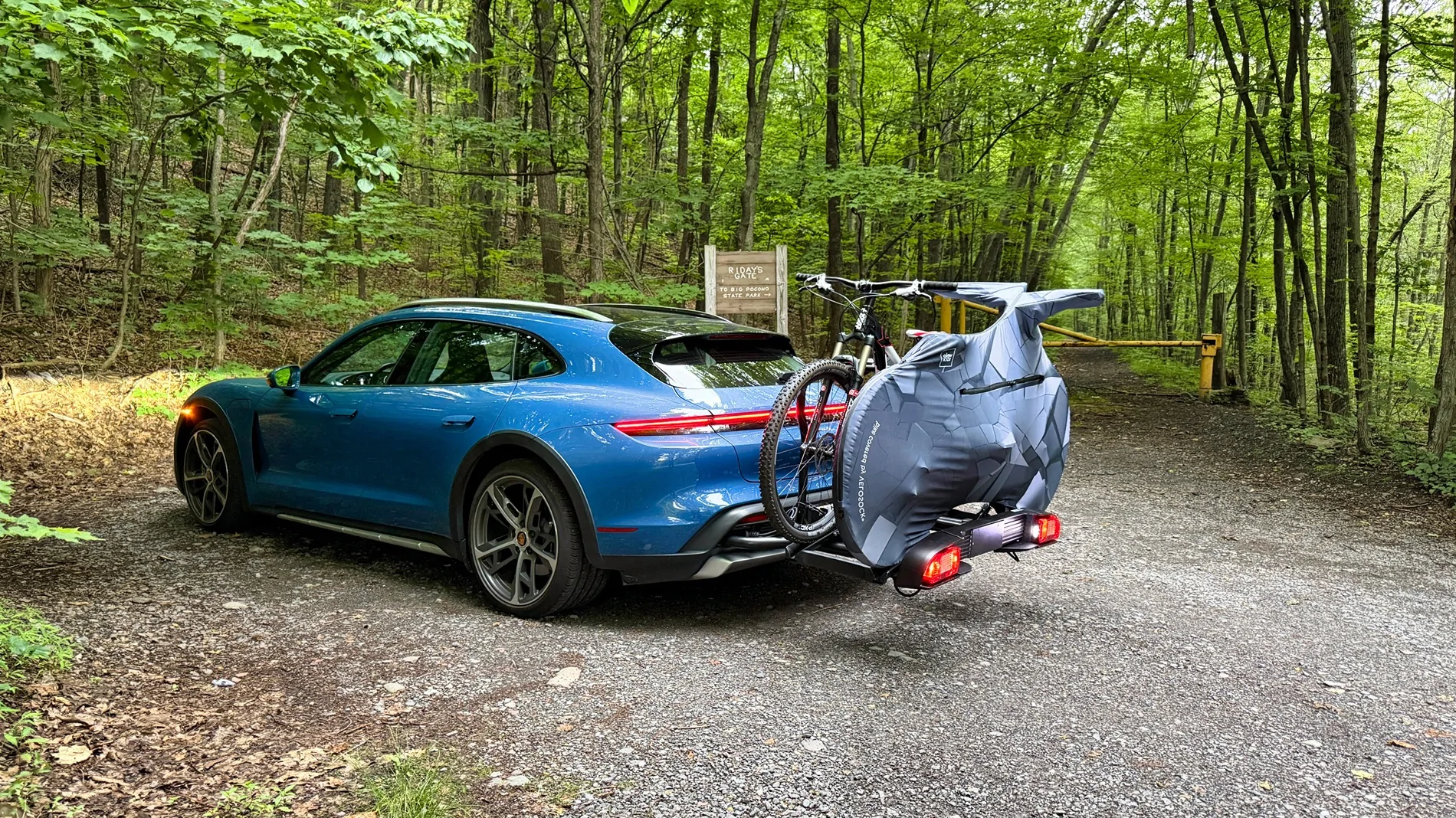

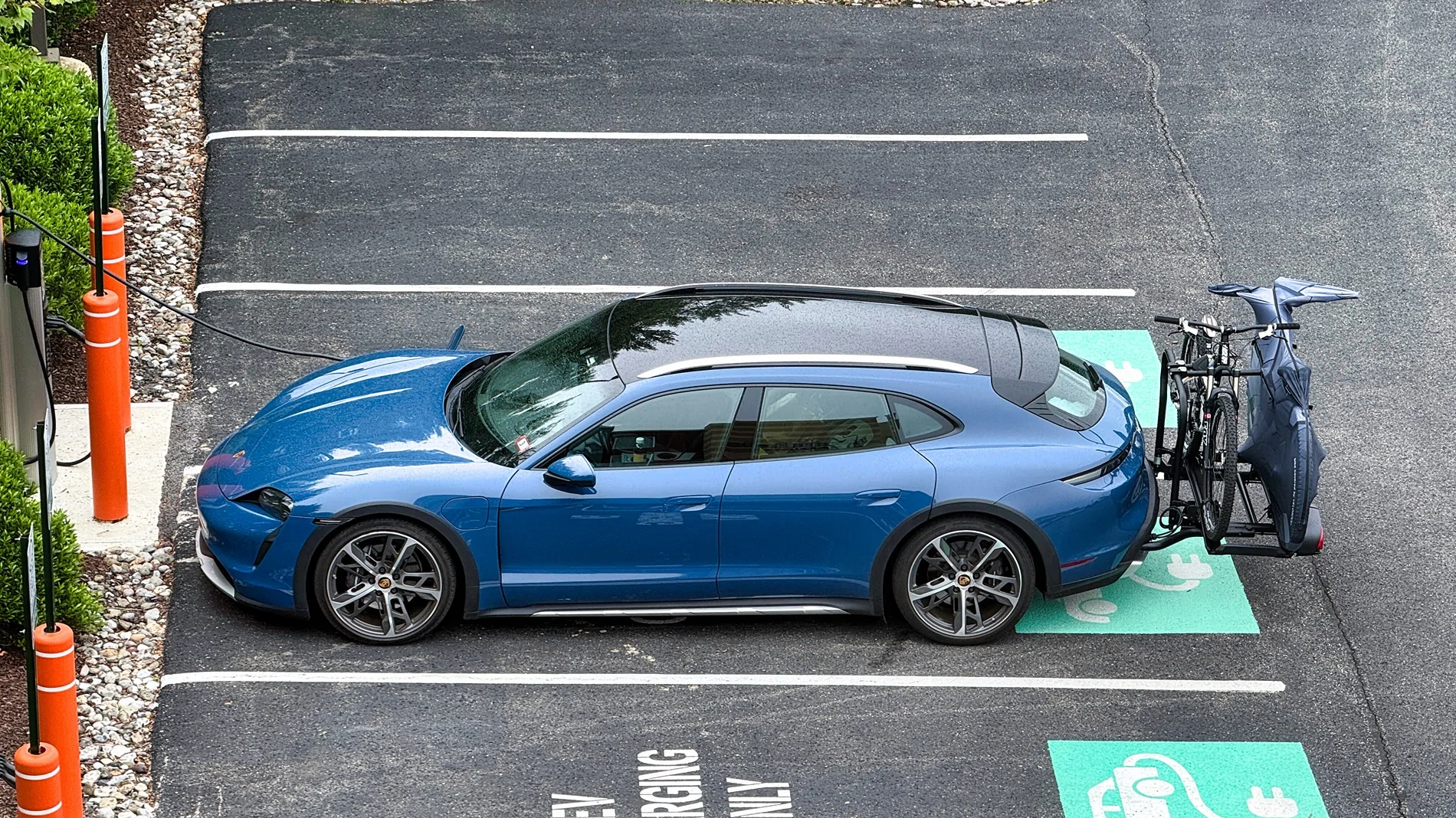

Terrific video! Thank you for posting this 😀
Could you talk a little bit about your experience backing up? I’m assuming the camera is of no use whatsoever, but do any of the safety systems automatically turn off?
The camera is on and you can see the bikes or rack when reversing. You still get a 360 type view which gives you an idea if you're going into the spot properly. You just don't get the normal view as the camera is blocked by the bikes.
When the lights are plugged in, it disables your lane departure warning system. It tell you LCA is not available when the bike rack is plugged in.
I bought a Velosock for my e-mountain bike. In the event it rains, I cover it so the debris from the road doesn't get into the components. If you do that, it's nice that the Porsche rack has the lights out back. This cover and the bike completely block the tail lights on the Taycan. I know on another post hearing people saying they don't need it in the US, however it's a safety thing.
Porsche Taycan Taycan Cross Turismo Bicycle Rack Install - DIY Video JPEG image-328DAC25040F-1

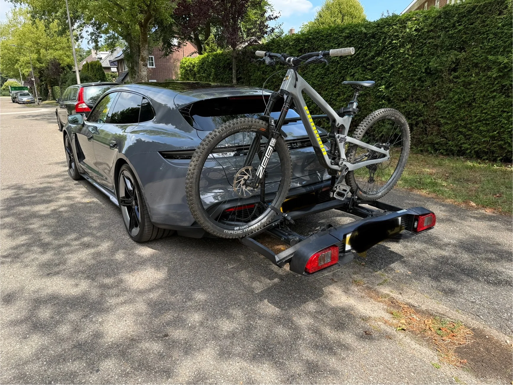

I recently leased a new Taycan Sport Turismo after previously owning a Taycan 4S sedan. The main reason I chose the Sport Turismo was to make it easier to bring our bikes on longer trips to the Alps, about 1,000 km. With my sedan, having the bikes mounted on the roof reduced the range quite significantly, by about 30 percent.
With the Sport Turismo and the Porsche rear bike carrier, I have completed one long weekend trip so far, and I am now on holiday with my family in the Austrian Alps also with the bike on the rear carrier.
My experience with the Porsche bike rack has been positive so far. The range reduction is much smaller so no longer a real issue, which is also helped by the improved range of the J1.2 version. The rear bike carrier is also easy to install and remove.
I did have to get used to the fact that the bike rack tends to wiggle at higher speeds, although this seems to be the case with most rear mounted racks.
Especially for my mountain bike with its longer wheelbase, XL size with slack geometry, the tire rails feel a bit short.
I also use the Thule carbon frame protector, but I have attached it to the frame near the seat post rather than on the top tube.
One thing that annoyed me at first is that the carrier needs to be clicked in very firmly to prevent it from tilting backward while driving. During my first trip, I had to stop 3 times because it tilted accidentally. Now I make sure to push it in firmly and double check that the bike rack is locked in place
Porsche Taycan Taycan Cross Turismo Bicycle Rack Install - DIY Video IMG_2721
