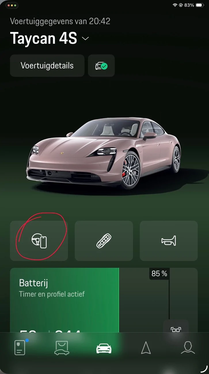

I have the Active Parking feature, but I can't figure out how it's supposed to work.
I also have never seen a steering wheel icon on the app, which is supposed to allow "summon" style backing out for you in tight spots.
I know I have the feature, it's on my sticker.
it’s this button. Never used it so far but I do love the active parking support Where she parks herself!
Porsche Taycan Active Parking - How? IMG_0043

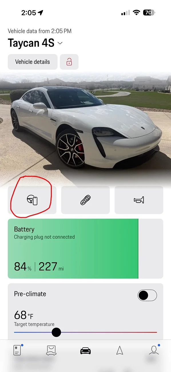

You don’t see that icon in your app?
Porsche Taycan Active Parking - How? IMG_0597
