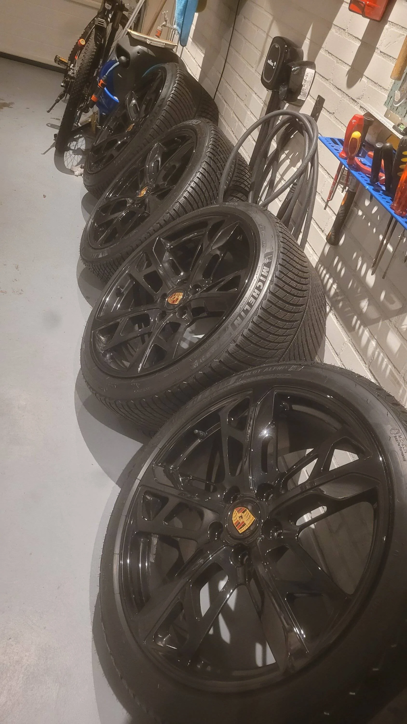

Just mounted Michelin Pilot Alpin 5 on 21 inch, non NF0 indeed, but I do believe when it comes to a dispute on any potential warranty issue in the future, a buyer has a lot of rights.
In my case, I use original Cross Turismo wheels with 305-30-R21 back setup and 265-35-R21 in front, the same width as the summer set up.
So what could possibly be wrong mounting these quality tires on 21 inch rims? Michelin is a quality brand....on original rims...what warranty dispute...don't think such a claim would hold in any court.
I want to drive 21 inch in winter...and oh yeah, 22 inch in summer. Oops non NF0 either.
