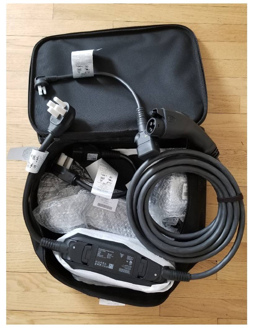

Not true. It should not require an additional module. The Taycan plug that fits in Taycan's Mobile Charger Connect looks very similar to the one used on the Panamera e-Hybrid but is not interchangeable. When I ordered my 14-50, the parts department originally received the Panamera plug that would not fit into my Taycan charger. We fixed the problem and found the correct part.
The piece that slides into the top of the charger is exactly the same on my 14-30 and 14-50 power supply cords. There is no adapter or module. It is also the same for the 110v power supply cord that you should have also received in the charger bag. All three slide into the charger without any adapters or modules. Attached is a picture with the 14-50 supply cord installed in the Charger. You can see there is no adapter or module.

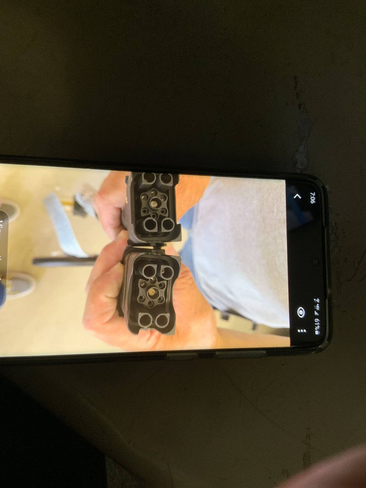

Wow. Now I’m thinking they ordered the wrong 14-50 plug. Would you mind taking close up photo of the inside part of 14-50 plug? There’s a model code inside. Really appreciate it...
Thanks in advance!
Thanks in advance!
Unfortunately, I can't take a picture of the inside of the plug. I am currently 1000 miles away from my car. I will be back around July 13th. I have the invoice from the dealership. The incorrect 14-50 plug (the one for the Panamera e-Hybrid) had a part number of 7PP-971-678-S (list price $286.68). The correct 14-50 plug for the Taycan has a part number of 7PP-971-678-ED (list price $120.21). Very similar part numbers except for the last letter. If I recall, the part numbers for the Taycan plugs (14-30 and the 110v) had similar parts number as the Taycan 14-50 except the ED was E and a different letter.
Thanks very much for all your help!!! I am also away but will be back in the morning and will double check what part # my 14-50 plug says.
You’ve been a great help! Enjoy wherever you are and be safe!!

Good news: Parts Dept gave me the Panamera e-Hybrid plug. Should have the Taycan plug early next week. Thanks again for all your help!!!
